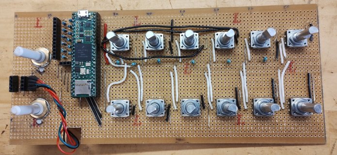

I was hoping to avoid having to learn how to use multiplexing if possible, especially as it would make for a more complex layout on veroboard for which a stand-alone Teensy 4.1 is perfect.
My previous MIDI controller for a software guitar amp managed to connect 12 encoders and their switches, 2 12-way rotary switches, an expression pedal, 6 foot switches and 18 LEDs directly to one Teensy 4.1 (see attached picture), but I'm currently wondering what kind of control surface is going to be best to create a simple to use recording/mixing set-up for the Cubase DAW. Preferably on Veroboard once again.MIDI Controller Board-1.jpg
That’s a very impressive amount of I/O already! I make it 85 “pins” if everything is done individually, plus however you’ve done the MIDI. I’d be curious to know how you’ve achieved that, if you have a diagram you can easily post.
Just by adopting EncoderTool and adding diodes, you could get the encoders, rotary switches and foot switches done with 12+6=18 I/O pins* and 66 diodes. Any vaguely sensible number of LEDs can be done by using a single pin and WS2812 addressable LEDs, for which there is extensive and easy to use library support.

Lots of helpful information there. Addressable LEDs are a new one to me.
MIDI output is via USB, the rest of the 'magic' was achieved as follows:
24 pins for the encoders.
1 analogue pin each for the 12 way switches which are wired with resistors as stepped potentiometers and the inputs detect 12 different input voltages.
1 analogue pin each for 2 rows of 6 encoder switches and 1 set of 6 footswitches (can be extended to 12 if required) which are wired much as the rotary switches. Only press one from each set at a time!
1 analogue pin for the expression pedal.
2 sets of 6 LEDs each are Charlieplexed onto 3 pins each. Only one LED of each 6 will be on a time so there's no need for complex multiplexing. The other 6 LEDs have dedicated pins.
Every standard pin on the Teensy is used. I did try soldering wires onto the pads for inputs 48-54 but only succeeded in pulling the pads off.
