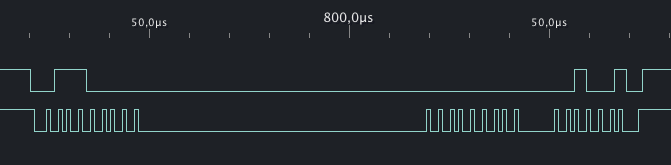

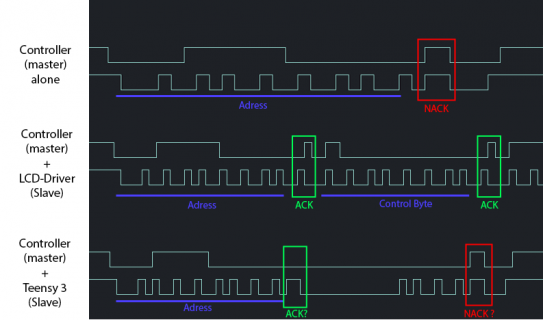

Furthermore did a little testing with the logic analyser, but I can’t figure why the acknowledging isn’t working.
Especially this example (Controller & Teensy) confuses me:
The terminal read out is:
I RSTART ASR
I SR D:00
^S:20
^S:20 –x-
The first ACK after the address is seemingly working, so the Controller sends the next byte. But this byte should be 10000000 and not 00000000. And after that I can’t interpret what’s happening.
I examined the circuit board again: Only the SDA line has an external pullup (4,7k), the SCA line is probably pulled up internally by the controller.
It may be that the SDA is driven as normal via resistive pullup but the SCL is driven as a CMOS signal. In a single-master setup with no clock stretching by the slave I suppose that could work, but it probably isn't a good way to do it.
One thing that I notice in the 3rd line in your 1st plot, is the fractional send by the master, it only sent 5 out of 9 clocks. At that same point of time I also notice that the SDA and SCL both going high at the same time. What might be happening is that the SDA is slower than SCL and if the Master sees SDA rising-edge while SCL is already high (because SDA is slightly lagging) it might interpret it as a STOP. Really SDA and SCL should not be changing at the same time.
Your 2nd plot is similar, only 7 out of 9 clocks on the last byte.
It could be that the capacitive loading is different than with the LCD so the edge behavior is different. You might try slowing SCL down a little bit (add some cap) to see if the problem goes away.

This isn't enough diagnostics to tell what is going on. The lines beginning with '^' are the SDA rising-edge ISR attempting to detect STOP conditions (for reasons too long to describe, the Slave mode needs help in this regard, so there is a separate ISR).
What is shown doesn't indicate a problem, did it output anything else? It may not have as this situation (partial byte received) is a bit unusual (it is actually difficult to generate this kind of error without some kind of bit-banging I2C wherein one can create malformed signals on purpose).
Thanks for that idea! I'll try it tomorrow; what scale would you suggest, some pF?
I would try something like that. If you had access to a scope you might be able to take a look at the problem edges and see what is going on a little better, but if not then iterating through some small cap values like that might work. It might be tricky - if you slow SCL too much it might fix the rising-edge SDA/SCL and give you a problem on the falling-edge SDA/SCL (if SDA falling-edge occurs when SCL is high it would create a START signal).
I'm not sure exactly if that is what is going on, but I can't think of other things that would kill a transmission in the middle of a byte.

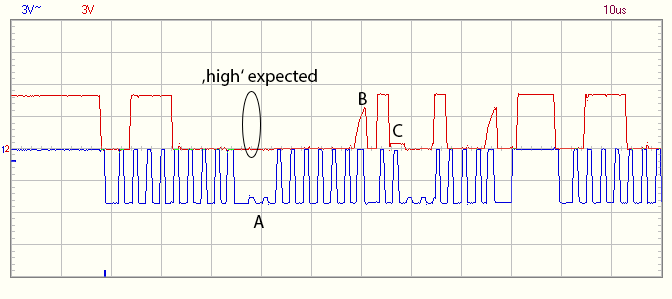

I think I figured it out … sort of:
The Teensy seems to stretch the clock after the acknowledgment of the address byte, while the master is trying to give the first two clock signals for the second byte anyway (A). Master and slave are then asynchronous, i.e. at point B the master is awaiting acknowledgment for byte 2, but the Teensy has missed two clock pulses and instead keep SDA low for acknowledgment a point C, while the master is applying its internal pull up in order to transmit 1 (the second bit of the third byte).
So far, so bad (for my project). What puzzles me is that the master seems to support clock stretching when communicating with the original LCD (I’ve seen it not right after the address byte, but later during the data bytes).
Furthermore the first bit of the second byte should be 1, but SDA isn’t high during the clock pulse. Is it kept low like SCL during clock stretching? Unfortunately I can’t understand the inner workings of the library concerning this aspect.
It's a little odd that the Master doesn't recognize the stretching. The voltage seems adequately low. First thing I would do, if you haven't already, is recompile with the debug routines turned OFF. The debug adds latency into the ISR, and while stretching is not explicitly done, my suspicion is that the I2C hardware will keep the ACK low until the data is read, so that latency could be the cause of the problem.
Overall the latency is very high (about ~10us), so something seems a bit wrong here. What version of the lib are you running, and what is your slave begin() command?
I'll have to hook up the logic analyzer and see if I can benchmark some different setup conditions. I'm pretty sure when I was running my back-to-back setup at the highest rate I wasn't getting 10us between data bytes. A longer term goal I had was to try to speed optimize the ISR (eventually using DMA) but I haven't had a chance to get to that. Let me know your setup command and I'll see if I can do some testing.
I finally got a chance to look at this a little bit. Indeed the clock stretching after the received byte is due to the ISR interrupt time. I typically see ISR times of about 3.5us with some a bit lower down to 2us. For a Slave this can also be highly variable depending on what is in the onReceive/onRequest callbacks.
I coded up a small bit-banged Master which uses the SCL in a forced mode (CMOS output, no pullups, and no clock stretching), and I can see a similar type of response as you show above. It was very easy to corrupt or drop clock bits which messed up the whole state of the Slave. You mention that the LCD was clock stretching on data, but you also mention that only SDA had a pullup. Given what I've seen, I'm inclined to think the Master in your setup might be intentionally putting out stretched clocks (perhaps to meet some LCD timing criteria), and that it doesn't actually support true clock stretching. I'm thinking this because I see the same thing as you when I use a forced SCL.
Unfortunately what this all comes down to is I don't think there is a fix for you using the code as-is right now. The operations in the ISR are necessary and in a particular order for proper functioning, and I don't see a lot of optimization potential. However that said, there might be some benefit from a DMA approach, but I'll have to spend some time studying that.
One other thing I did notice - the small delay between bytes is due to the ISR, but the Slave also seems to enforce a particular bit timing given whatever baud rate it is initialized with. So if a Slave is initialized at 100kHz and a Master tries to talk to it at 400kHz it will stretch every bit. Therefore it is important to have a Slave match or exceed the Master rate.
