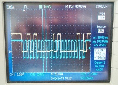

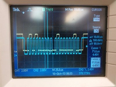

I2C issues
I am having issues using a T3 to communicate with a Newhaven LCD. (http://www.newhavendisplay.com/specs/NHD-0420D3Z-NSW-BBW-V3.pdf). I am using a NXP PCA9306 (http://dlnmh9ip6v2uc.cloudfront.net/datasheets/BreakoutBoards/PCA9306.pdf) to get the voltages to the proper levels. 1k pull ups are used.
The display works perfectly, verified with Arduino Duemilanove.
Every 100-200 write attempts the a letter may be displayed when using the T3.

The above picture shows what the command to display an 'A' looks like from the Arduino.
Above pictures shows what the same command looks like from the T3. Notice the rise in the SDA after the ACK, it happens after every ACK. I think it is the ACK, it rises just after the 9th bit.

Addition: I enabled I2C_DEBUG and the display started to work. This isn't a solution but may help.
Addition 2013-10-12 : Evidently the Newhaven display can't handle the narrow pulse width after the ACK/NACK. I couldn't find a referenced that said exactly what the width had to be. I ended up putting a loop in the i2c0_isr that just counted to use some time.
for(xx=0; xx<10; xx++){ }, xx had to be declared as a volatile
The width widened and the display began to work. There has to be a better fix but for now this will work.

That is a curious thing. The "spike" is happening at the ACK handover. Basically at that point in the communication the Master releases the data line and the Slave pulls it low (that is the ACK). As long as the SDA spike occurs when SCL is low it is not in violation of the spec. That appears to be the case.
My guess here is that the resistor pullups are too low for the given communication rate (the pullups are too fast - the edge rate is too high, which is why the voltage jumps up quickly at the ACK handover). For a 100KHz rate (as given in your code), the resistors can be a higher value. Try using 10K or higher and see what happens.
The other alternative is to perhaps create a new slower rate (it would require digging into the I2C settings). To some extent the I2C module enforces latency timing according to the rate setup. Or as you have done, manipulate the ISR timing to slightly delay when things occur. But I really think the easier solution is to change the resistors.
EDIT: Sorry I looked at it wrong, the spike is after the ACK, not before it as I initially thought. It is when the Slave releases the bus and the Master takes over again. It really should not be causing a Slave problem. It is not a spec violation (since SCL is low), perhaps there is some wiring crosstalk to the SCL line on the Slave side? Regardless I would still try some slower resistors, 1Kohm for low rate like 100KHz seems too low for me.
Another minor thing - it looks like your are running 5V I2C bus. The datasheets are confusing, but I've read elsewhere that the I/Os really should be limited to 3.3V. See this thread. Since I2C uses a pullup resistor, it has inherent current limiting. Actually replacing your 1Kohm with 10Kohm will improve this situation as it limits the ESD diode current further.

nox771 - Thanks for your reply. You are correct, spike is after the ack. When I lengthened the 'spike' communication began to work, well mostly. I have concluded that some of the issues are with the display. I tested the display with a couple different controllers and now they all give me the same, albeit inconsistent, results.
You are also correct, the display is 5V. I am using a NXP PCA9306 device to change the levels. 3.3 on the T3 side and 5V on the display side. I am confident that the level shifter isn't causing problems.
I will try different pullups and report back.
