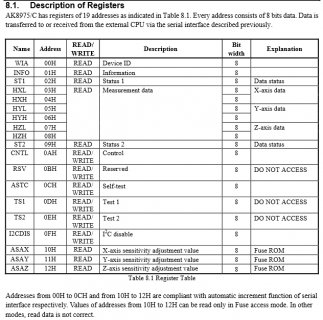

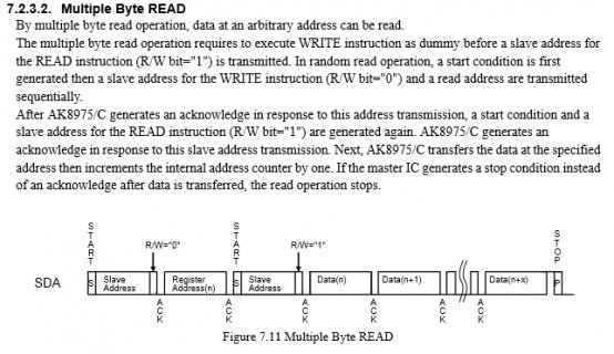

Perhaps I'm missing something here, I pulled a datasheet for a AK8975, and I found the following section on multi-byte I2C (click to expand):
Is this the right part? I don't see anything about the 0x80 address modification below. Where is that coming from?

The way these things usually go, is that if the low-level routines work (as demonstrated by talking to the other components), then there is some higher level comm problem (eg. reading 1 byte of a 3-byte register, parsing multi-byte data backwards out of the buffer, etc). If the 0x80 address modification is necessary can you supply a link to a datasheet showing that? I don't think I've ever seen a part that worked that way.
I just blindly (an dumbly, it turns out) copied the wire routines from the LSM9DS0 sketch (https://github.com/sparkfun/LSM9DS0...Libraries/Arduino/SFE_LSM9DS0/SFE_LSM9DS0.cpp). In that device's data sheet (https://cdn.sparkfun.com/assets/f/6/1/f/0/LSM9DS0.pdf) we find:

I removed the 0x08 OR and, of course, the multiple byte read now works. Thank you very much for the education. I have usually gotten away with copying commo routines; in the future I will pay more attention to the details, which apparently, and no surprise, matter!
