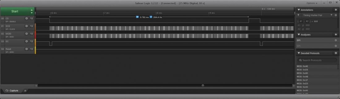

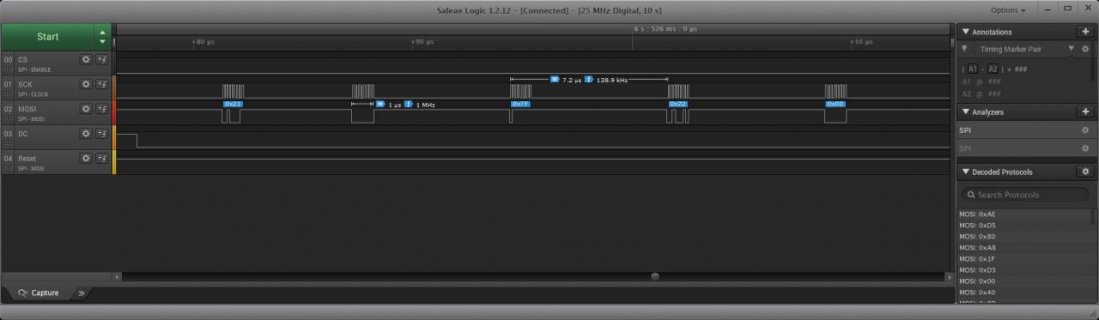

Last night when I read your post you were asking what a Logic Analyzer is. It is typically it is a test hardware. Mine are from Saleae: https://www.saleae.com/
For other types of tests you might want to use an Oscilloscope, which at times I wish I had... Note: there is a sketch to turn a Teensy into a Logic Analyzer which can be used for some things... I have not tried it too much but you can gather some information from it.
Example usages: Yesterday I was testing out adding Async SPI support to the Teensy 2.0. Took me a second to figure out which pins are SPI on it... Then hooked up analyzer and verified that things looked right. Example screen shots. First one shows a complete screen update, you can see that the CS pin is properly asserted through the complete update, plus the DC pin is asserted for the first several bytes:
Then if you zoom into the start update, you can see the actual bytes that were output. I added a couple of timing annotations showing some timings. Like the time to output one byte (1us) which shows then 1mhz, which if you multiply by 8 you will get 8mhz which is the SPI speed I asked for. You see a second annotation showing time between byte outputs of 7.2us so using this method where each byte is output by an Interrupt handler you are actually getting a throughput of about 1.1mhz which is pretty bad!...
