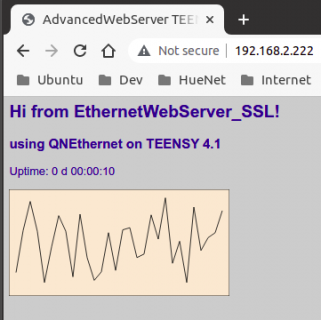

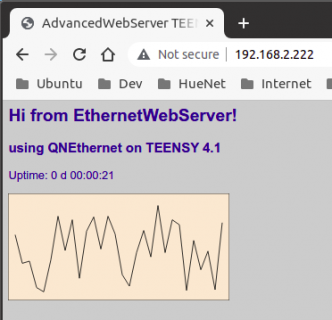

EthernetWebServer Library now support QNEthernet on Teensy 4.1.
A new release will be published in this weekend
EthernetWebServer v1.6.0 has been released to support this QNEthernet library.
The following is debug terminal output when running example MQTTClient_Auth on Teensy 4.1 using QNEthernet Library
Start MQTTClient_Auth on TEENSY 4.1 using QNEthernet
[EWS] =========== USE_QN_ETHERNET ===========
Initialize Ethernet using static IP => IP Address = 192.168.2.222
Attempting MQTT connection to broker.emqx.io...connected
Message Send : MQTT_Pub => Hello from MQTTClient_Auth on TEENSY 4.1 using QNEthernet
Message arrived [MQTT_Pub] Hello from MQTTClient_Auth on TEENSY 4.1 using QNEthernet

EthernetWebServer_SSL Library now supports QNEthernet on Teensy 4.1
The following is debug terminal output when running example MQTTClient_SSL on Teensy 4.1 using QNEthernet Library
Starting MQTTClient_SSL on TEENSY 4.1 using QNEthernet
EthernetWebServer_SSL v1.6.0
[ETHERNET_WEBSERVER] =========== USE_QN_ETHERNET ===========
Attempting MQTTS connection to broker.emqx.io...connected
Message Send : MQTT_Pub => Hello from MQTTClient_SSL on TEENSY 4.1
Message arrived [MQTT_Pub] Hello from MQTTClient_SSL on TEENSY 4.1
