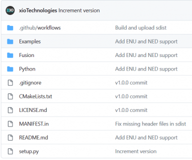

While updating my version of Fabio Versano's FreeIMU library I was looking for some of Madgwick's old papers and came across the fact the Madgwick changed what we have known as MadgwichAHRS. This occurred with the publication of his PhD thesis: AHRS algorithms and calibration solutions to facilitate new applications using low-cost MEMS and available on Github: Fusion. Its a quite a bit different than our current version of his AHRS algorithm. This is from the readME:

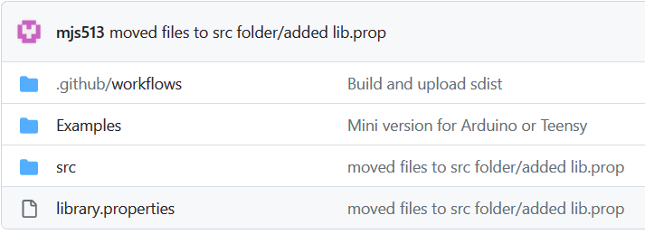

I have a stripped-down version of the library at: https://github.com/mjs513/Fusion/tree/Fusion-Teensy. There are 2 additional examples:
1. FreeIMU_Madgwick_Fusion: Used with my FreeIMU library and
2. NXPFusion_Madgwick_Fusion: Used with NXPMotionSense library.
As before the Fusion library requires calibrated data to be supplied to the algorithm.

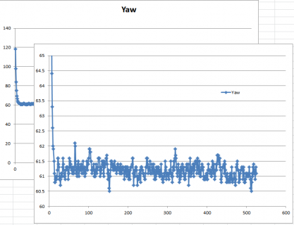

One thing I noticed with preliminary testing with the propshield using the Fusion algorithm or the MadgwickAHRS algorithm is that the new Fusion library has just about 0 yaw drif where the old version (using the NXPMotion example) youdo see alot of yaw drifting.
I will try to post some comparison data later.
