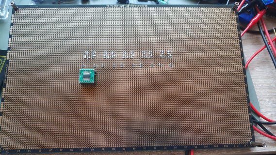

I have now successfully installed the six I2C encoders in the Degenerator 2. Underneath each encoder is a small ATtiny402/412 chip that communicates with the Teensy4.1 board via an I2C bus. To avoid "crank trauma" with the large number of encoders, I have programmed a dynamic acceleration for each encoder.
Encoder check

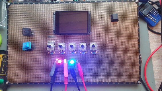

Hello there..
The ordered prototype PCB board with the buttons arrived today. The board has a size of 320 x 200 mm and has round solder pads on both sides. So there is enough space for a lot of control elements such as encoders, buttons and LEDs.
To the left of the display is the encoder for selecting sound programs, samples, etc. Below the display are the encoders for entering parameters.
I'm not quite sure about the buttons yet. With the black buttons you can call up a menu directly, e.g. Osc, Filter, Effects, Modmatrix etc. On the left and right there are coloured buttons for different things, e.g. LFO LEDs and sequencer
Push buttons with coloured LEDs

I2C encoder board, e.g. from DuPPa.net
with an ATtinsy 402 CPU installed
View attachment 36786View attachment 36787
I have been using Duppa products in my projects for a long time. They work very well and allow you to connect many encoders with only 2 pins of the Teensy. Duppa also sells very easy to use i2c led rings.
For the keys, I chose nice, soft Cherry keys with transparent and black keycaps.
Since the keys can be fitted with LEDs, I will also install blue LEDs. There will also be a nice, large red modulation encoder made of aluminum to control the cutoff or other targets using this button, for example.
The Cherry keys feel very good to the touch and have a good pressure feel. They are inexpensive and can be easily combined in terms of color and equipped with 3mm LEDs. I chose black, black/transparent with red LEDs and blue/transparent with blue LEDs for the keycaps (see picture). Today I'm going to solder and drill. Since I can't solder the small SMD chips (ATtiny CPUs) for the encoders directly onto the mainboard circuit board, I soldered them onto small adapter boards. In order to address the individual CPUs directly via the I2C bus, each CPU has four solder bridges for addressing. The CPUs are not only responsible for quickly scanning the encoders, they also control LEDs on the mainboard.
Font
Another update...
All knobs and buttons are installed and positioned. I've reordered some black and transparent keycaps. There's also an LED ring for the modulation knob. It's sure to look great. We'll see...
