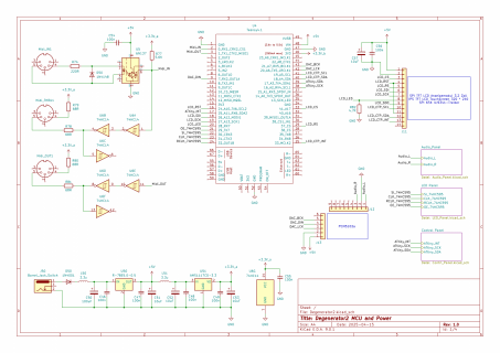

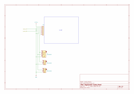

The first circuit diagrams from Degenerator2. Circuit diagrams for the MCU, power supply, MIDI, and display are coming soon.

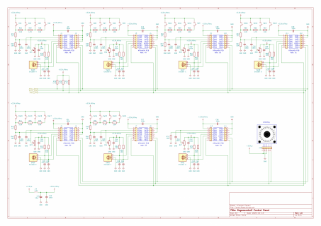

The control panel consists of seven ATiny404 modules. Each module has an analog input for four buttons, an analog input for a potentiometer, and a digital input for an encoder. The module is addressed via solder bridges on the mainboard. Pressing a button, encoder, or potentiometer generates an interrupt signal on the ATtiny processor (PB3). The interrupt signal is sent to the Teensy processor via the bus line and evaluated.

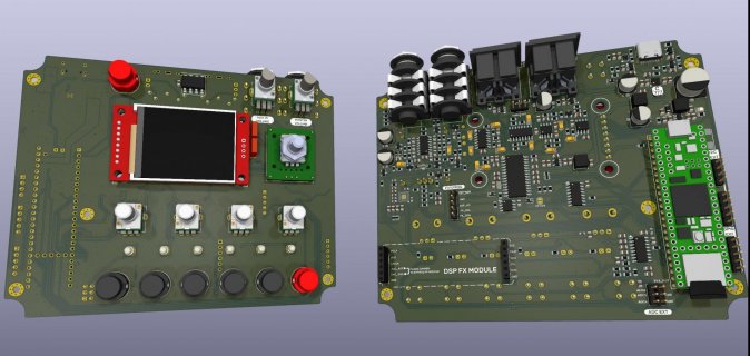

Degenerator2 Prototyp
My prototype schematic is finished. One or two things will definitely change. For example, the decision as to which effect module will be used in the Degenerator2 isn't quite clear yet. But the time will come, and the idea will come ;-) With that in mind, I wish you all a happy Easter and always keep your hands on the instruments :unsure:
Really nice project Rolf!
Besides, just wanted note how elegant and intuitive the schematic drawing is. Beauty!

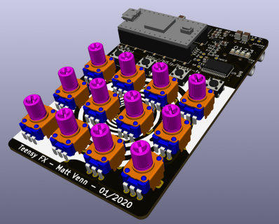

For the FX module, perhaps this could be an inspiration. Some time ago i started to work on an adaptation of the Jeannie Synth, with most components being SMT, AUX in (using codec instead of an DAC only), already built in FV-1 and other tweaks.
One of them was adding a 2nd module with Teensy4.0 used as a pure FX processor only, acting as "middleman" between the main T41 and the DAC.
The FX Teensy module would work as I2S slave, receiving all the clocks from the main T41 and being inserted in the I2S data line. Bypassing it, if the module in not used is easy by bridging the Send/Return I2S data pins. Parameter control would be done over I2C.
In the end i did not finish the project, it has some HW changes, which would require to mod the original Jeannie firmware. I wasn't sure if i will have enough time to do all the changes and maintain the alternative version. So it ended up being just a design excercise.
Nice Jeannie project. I also had the idea of using the Teensy 4.0 for digital effects. But the question is, can you clone the beautiful effects from the FV-1 with the Teensy 4.0?

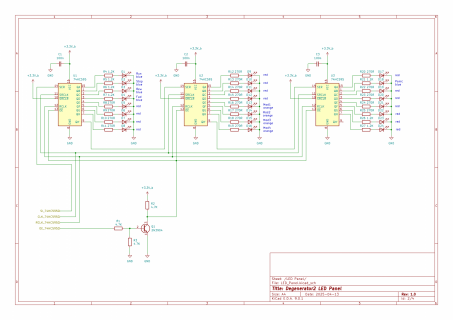

Regarding the last post: I used the 3.3V voltage from the Teensy4.1 (I2s master) to control the LED driver (24 LEDs). The LEDs are low-current and consume approximately <50mA together. When the +5V supply is switched on, the LEDs are off.
I use 7x ATtiny404s for the potentiometer and button sensing. The ATtinys are powered by a separate +3.3V voltage (not via Teensy). The ATtinys are connected to the Teensy4.1 via an SPI bus. The 4.7K SPI pull-up resistors are connected to the separate +3.3V voltage.
I'm going to change the circuit now. I'm going to separate the +3.3V voltage from the Teensy4.1 for the LED drivers and connect it to the separate +3.3V voltage. This way, I don't have any load on the 3.3V pins of the Teensy

Because of the defective Teensy4 modules there are now changes in the circuit diagram of the Degenerator2.
There are changes to the Degenerator2 power supply circuit diagram. There is now only one +3.3 V power supply.
The +3.3 V power supply of the Teensy4 modules is no longer used.
For the parameter control of the Teensy4 effects module (U7), I soldered a 1 kΩ resistor to the RxD input (pin 2) of the Teensy Fx (U7) as a precaution.
In the event of large voltage differences between the two Teensy processors, the TXD output of Teensy4.1 (U4) is protected.
The Teensy4.1 is programmed as an I2S master and sends its digital audio data via the I2S bus to the Teensy4.0 Fx processor (U7).
The Teensy4.0 (U7) is programmed as an I2S2 slave Input and sends its audio data directly to the PCM5102 DAC.
Degenerator2 Circuit Diagram V1.2
