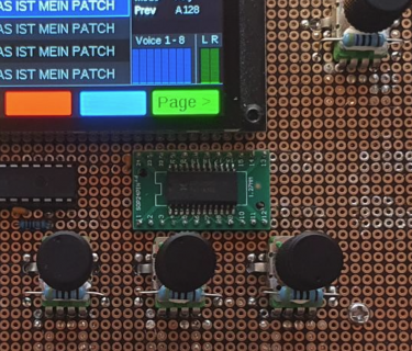

I've made some hardware changes. The 24 buttons are now controlled by two MCP23017 16-bit I/O expanders.
The encoders have been replaced with Alpha 360-degree endless rotary potentiometers.
The seven Alpha potentiometers are controlled by a 74HC4067 16:1 analog multiplexer and two analog inputs on the Teensy4.1.
Compared to encoders, the 360° Alpha potentiometers have the advantage that no time-critical query is required from the processor.
I've removed the seven ATtiny chips that were responsible for controlling the encoders, buttons, and potentiometers.
MPC23017 for key scanning
16:1 Analog Multiplexer 74HC4067
Hello friends,
The new Alpha potentiometers are a bit too stiff for me personally. For this reason, I was looking for a simple solution to make them a bit smoother.
Unscrewing or opening the Alpha potentiometers was out of the question, as I wanted to spare people who wanted to replicate the Degenerator2 the process. But a coincidence came to my aid. When I soldered the Alpha potentiometers in place, they became a little easier to turn. Once the potentiometer cooled down, they became stiff again. So I thought, just heat the thing. I quickly found a 330 ohm resistor, and the existing 12V power supply in the degenerator was available. I simply soldered the resistor over the Alpha potentiometer and connected it to the 12V supply. The resistor heats up and warms the Alpha potentiometer. Compared to a non-heated Alpha potentiometer, the heated Alpha potentiometer turns much more easily. The tactile feel is now similar to that of the encoders in the Blofeld.
Addendum: A dab of thermal paste improves thermal contact with the potentiometer ;-)
Addendum:
I've experimented a bit more and found that 470 ohm resistors are optimal for the Alpha potentiometers.
The 330 ohm resistors had overheated and made the Alpha potentiometers too easy to turn.
I used SG100X from Silverbead as the thermal adhesive.
Heated potentiometers... "The best ideas are always the unusual ones," someone once said.
This gives the Degenerator 2 an exceptional unique selling point ;)

The next step in Degenerator2's development is the oscillator section. The oscillators will feature VA Synthes, Wavetable, and Sample Synthesis similar to the Jeannie Synthesizer.
Greetings from germany. Rolf :)
