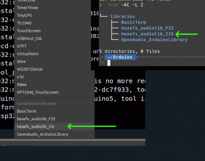

Thanks for the post, but it's not how to implement the library in code I'm worried about - I have the GUI tool for that.
It's how to add the effects to the libs I'm unsure about. I've never installed third party libs before.
Scroll down to the Manual Installation section and follow the steps.
Works with the IDE v2, too:
Since I used the older t40fx library, I manually added the "effect_platervbstereo.h" and "effect_platervbstereo.cpp" to the arduino project folder to access them.
