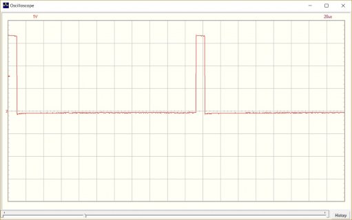

I did measure it with and without anything connected, with the same result.
if I do a digital write to the same pins they output 3.3 volts as expected. I'm sorta clueless.
Just to make sure that Teensy and scope are working, I'd test if this gives 10µs pulses on your scope:
constexpr int pin = 0;
  pinMode(pin, OUTPUT);
  digitalWriteFast(pin, HIGH);
  delayMicroseconds(10);
  digitalWriteFast(pin, LOW);
  delayMicroseconds(200);
strange, I think you got the point, though I'm not sure why the servo motors don't run.
I tested it with an arduino uno before and they had no problem.
here's my scope output generated by your test code: Scope.jpg
I'm again clueless now.
I measured directly at the teensy pin and for now I use a ULN2803A darlington transistor array as a driver.
of course the teensy output doesn't switch the transistors properly.
for any reason it seems to be a timer issue. I suspected platformio to be the problem, but I got the same result using arduino IDE
If you can post a minimal example sketch showing the effect I can try to reproduce and dig further into it.
Thanks luni for all your help.
Finally I figured there where a few issues, that in combination made no sense and caused me to not figure the actual problem.
First problem: my oscilloscope obviosly suddenly died, or shows wrong values on a wrong timebase, on both channels wich was misleading
second problem (the actual problem why it didn't work): I made a mistake in the driver circuit -> forgot to pull up the outputs :D

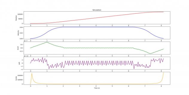

Thanks for the great library! Have you given any thought to adding support for s-curves?
I wrote a small python script that can be used to test/simulate different "motion profiles" using TeensyStep.
Yes, thought of that but the need was never big enough to really implement it. I could offer to implement a hook function which will be called whenever a new acceleration value is needed. You could then implement any acceleration you feel is appropriate for your application. Would that make sense for you?
That would be great! In my own tweaked version here I made it delegate the initial (from doStep) and update calculations (from the accUpdateChannel) to a class that can implement the methods as needed.

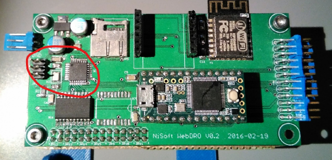

If you are interested I can post schematics, I should also have a couple of empty boards lying around somewhere...
Sure I'd be interested in checking out the schematics if you can pm them to me. Yes, I've heard of grbl but haven't tried it yet as i'd prefer to do everything on the teensy.
S-curve's are working in the simulation but there's some issues that seem to be related to floating point math / overflows or something on the actual teensy (3.2). It works fine for 25k steps/s on my desk but at 60k steps/s on the engraver I'm getting strange behavior on larger distance moves (works well for movements up to around 120k steps).
Here you are: View attachment drive-download-20181205T110944Z-001.zip

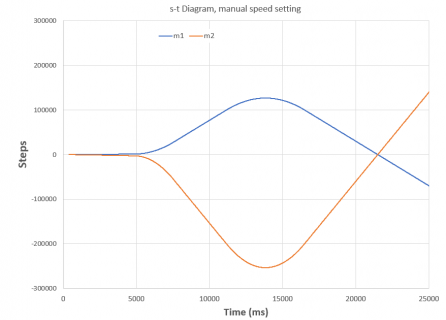

And here the recorded s-t diagram recorded with the sketch from above. I manually changed the speed at ~5000ms and ~12000ms.
