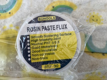

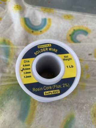

This has been a very terrible and expensive lesson in flux. I have processed and used at least 100 Teensys in a similar manner, leaving the "no clean" flux on the board and I've had no problems at all - until now. This was a new flux, a "freebie" I got with new 63/37, and I'll never do that again. On closer inspection, it didn't actually say "no clean." It said everything else - neutral PH 7, non-corrosion, etc:
I am also leery of using the solder from the same company now, since it contains the same flux:
I'd rather bin it than have more failures, as this is getting expensive and humiliating.

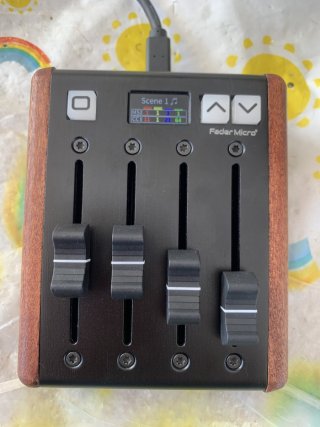

EDIT: after all this, I thought you might like to see one of the products I make with the Teensys:

About the solder you are using: I wonder if I can talk you into trying a low flux content solder? You stated a few messages back that you briefly tried without success. Perhaps you should try it another time? Please buy solder from reputable brands. Bohools is an unknown ShenZhen brand.
This is the solder I use for more then 10 years now: https://www.rapidonline.com/multicore-loctite-288322-362-60en-5c-solder-wire-0-7mm-0-5kg-85-6215. I never clean the parts after soldering...

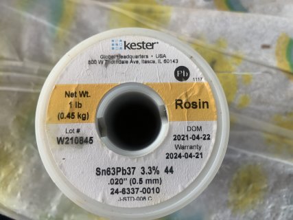

I haven't actually used that Bohool solder yet - only the flux - I've been using Kester 63/37 the whole time.
I will check out what you shared. I have 3 lbs of the Kester at the moment - Kester should be OK though, right?

Here's a pic of the Kester I've been using the last 3 years (1lb roll lasts a LOOOONG TIME!):
That's interesting: that solder has 3.3% rosin flux. So it should flow nicely. Is the temperature of your Metcal station set high enough?

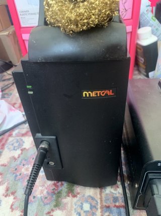

It doesn't have temperature control...it's one of the older ones, and uses some kind of induction heating (I forget how it works). I can say, with a large tip, it gets very hot, and with a smaller one, hot enough...

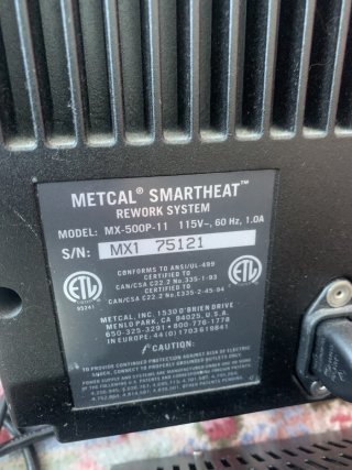

I'm using a heavy duty step up/down transformer...it does 230-115 and vice versa, although right now in the photo the wall wart is covering the 115V plugs, which are hidden below it.

If your METCAL is like the one we used to use in our development lab (when I was working . . . now retired), the soldering temperature was determined by the specific tip that was plugged in (IIRC, there were 600 degrees F tips & 700 degrees F tips that we used). You may want to verify the exact specs on the tip that you are using.
Hope that helps . . .

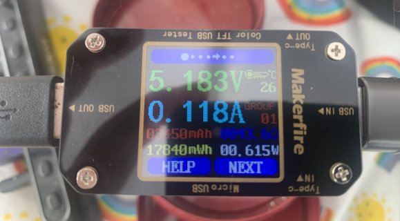

Hi, I just wanted to follow up with this thread. I bought the USB sniffer Paul suggested and used it.
For the one board that never revived, it shows power consumption of 0.497A with nothing hooked up besides the Teensy. No LEDs, no screen, no faders, nothing.
So I think this tells the tale: there's some kind of short or something fried on the Teensy due to the dirty flux. A Teensy should never use 500mA at idle - I think more like less than 100mA.
Another units that was defunct, that revived after thorough cleaning with a flux cleaner, shows power consumption of ~ 0.120A, WITH the 12 LEDs hooked up AND an LCD screen:
Incidentally, LEDs are run with PWM, so they are not at full brightness most of the time; hence the lower than expected total power consumption.
