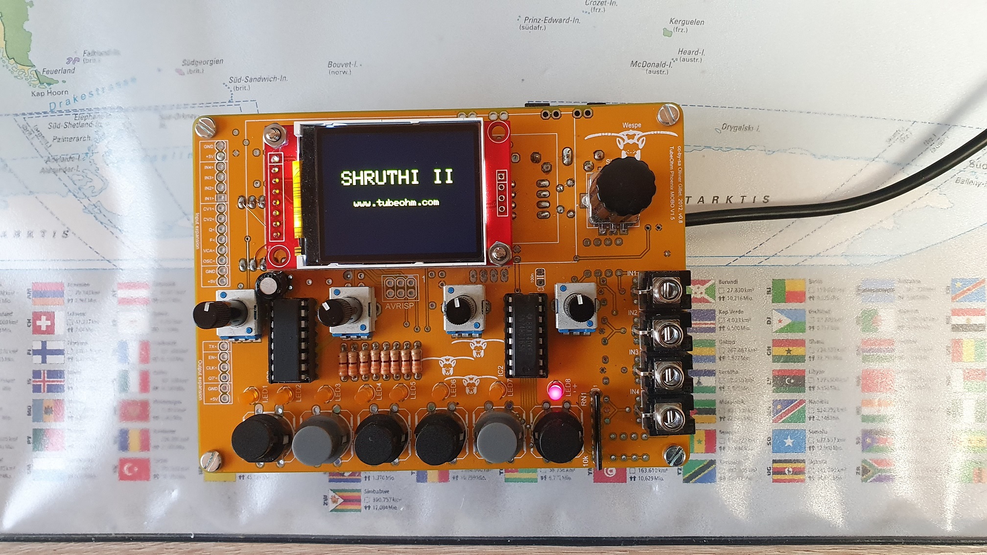

Hi there...
I am currently developing a new DIY synthesizer based on a
Teensy 4.0 Boards. The synthesizer will look similar to the small
Shruthi Synthesizer from Mutable Instruments. Compared to the Shruthi
this synth will be polyphonic, have a color TFT display
and other things like a 2Channel 16Bit DA-Converter, digital and
analog filters. The housing and board format is similar to the
Shruthi (see picture). That's why for the DIY Project I also created the
Name "Shruthi 2" selected.

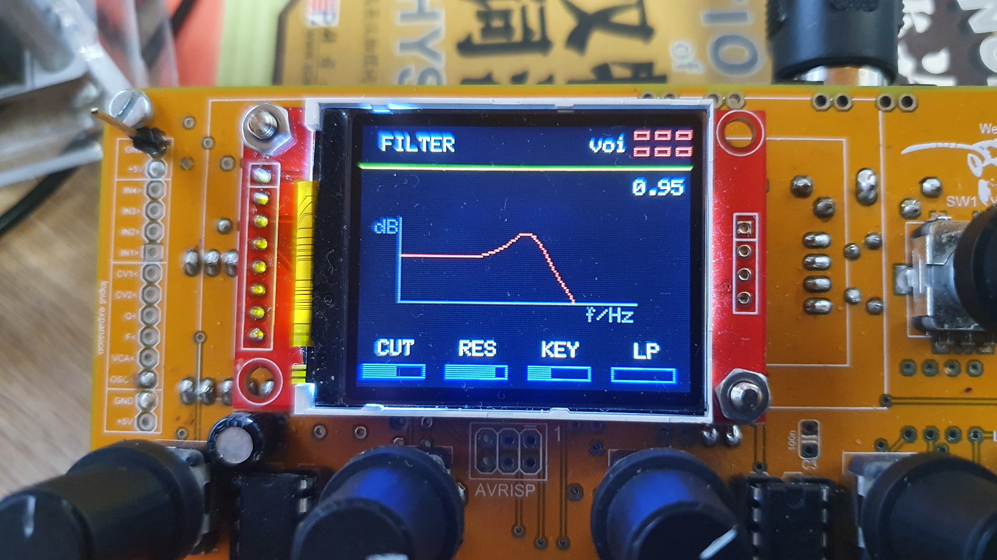

I replaced the 2.2 inch TFT display with a smaller 1.8 inch
Display replaced. I think this fits better to the small
Shruthi format. The 2.2 inch display is a bit overloaded
looked like. Waveform displays and menu texts also fit like this
a small color display with a resolution of 128 x 160 pixels

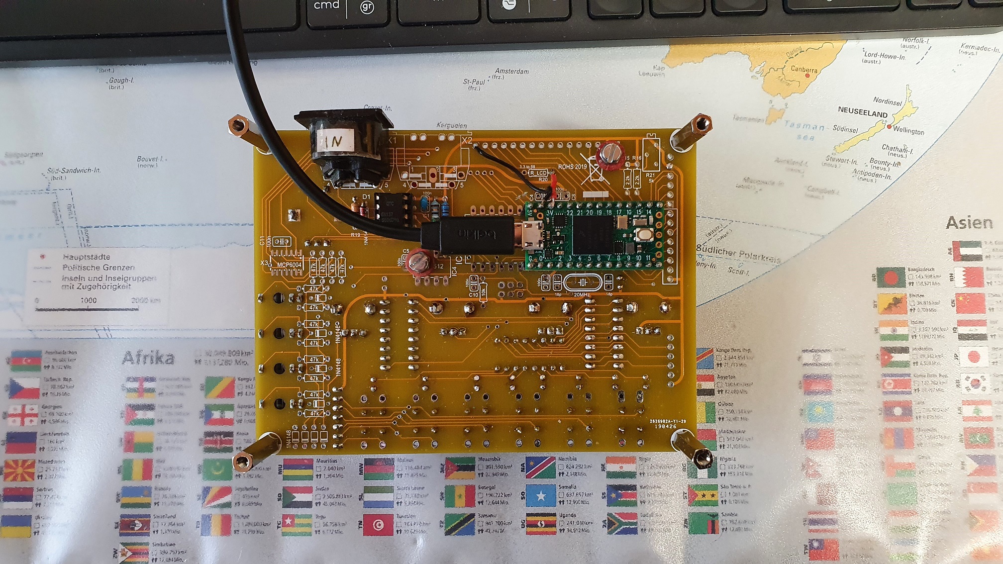

I put the Teensy 4.0 board on the backside. What is still missing
is the 16Bit 2Ch. DA-converter PT8211. This is ordered. With the 4
Potis you control the parameter setting. The encoder is equipped with a
key function and controls the menu functions. There are 4
analog inputs for modulation. Midi sockets and 6 keys and 8 LEDs.
There will be the possibility to use the "Shruthi 2" with or without filter board
to operate. You then have the possibility to use the digital filters in the
Teensy to use.

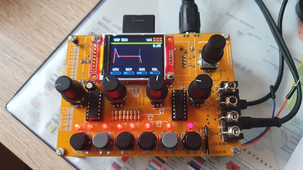

The "Shruthi 2" now has 6 voices and plays polyphonically. I think you can expand that to 8 voices, since the processor load including the filter calculation is below 6%.
There is currently only one oscillator per voice. But later there will be 2 per vote. The oscillator functions are not yet integrated. This is my next step now.
The sound is still being worked on. There is still a lot to program. Let's do it ;-)

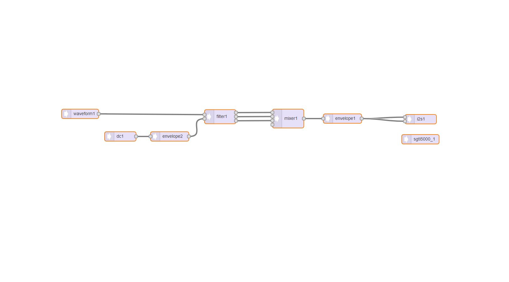

AudioSynthWaveformDc     dc1;            //xy=393,162
AudioSynthWaveformDc     dc2;            //xy=387,383
AudioSynthWaveformDc     dc3;            //xy=385,590
AudioSynthWaveformDc     dc4;            //xy=382,789
AudioSynthWaveformDc     dc5;            //xy=380,959
AudioSynthWaveformDc     dc6;            //xy=376,1152
AudioSynthWaveform       waveform1;      //xy=399,92
AudioSynthWaveform       waveform2;      //xy=395,317
AudioSynthWaveform       waveform3;      //xy=394,528
AudioSynthWaveform       waveform4;      //xy=393,735
AudioSynthWaveform       waveform5;      //xy=389,909
AudioSynthWaveform       waveform6;      //xy=387,1093
AudioEffectEnvelope      envelope1_0;      //xy=1101,105
AudioEffectEnvelope      envelope2_0;      //xy=1104,331
AudioEffectEnvelope      envelope3_0;      //xy=1104,539
AudioEffectEnvelope      envelope4_0;     //xy=1106,745
AudioEffectEnvelope      envelope5_0;     //xy=1108,923
AudioEffectEnvelope      envelope6_0;     //xy=1110,1105
AudioEffectEnvelope      envelope1_1;      //xy=559,162
AudioEffectEnvelope      envelope2_1;      //xy=548,382
AudioEffectEnvelope      envelope3_1;      //xy=539,590
AudioEffectEnvelope      envelope4_1;      //xy=538,789
AudioEffectEnvelope      envelope5_1;      //xy=536,959
AudioEffectEnvelope      envelope6_1;      //xy=537,1152
AudioFilterStateVariable filter1;        //xy=723,99
AudioFilterStateVariable filter2;        //xy=718,325
AudioFilterStateVariable filter3;        //xy=712,533
AudioFilterStateVariable filter4;        //xy=709,739
AudioFilterStateVariable filter5;        //xy=711,917
AudioFilterStateVariable filter6;        //xy=713,1100
AudioMixer4              mixer1;         //xy=936,105
AudioMixer4              mixer2;         //xy=931,331
AudioMixer4              mixer3;         //xy=930,539
AudioMixer4              mixer4;         //xy=931,745
AudioMixer4              mixer5;         //xy=931,923
AudioMixer4              mixer6;         //xy=929,1106
AudioMixer4              mixer20;         //xy=1351,498
AudioMixer4              mixer21;         //xy=1351,942
AudioMixer4              mixer22;         //xy=1560,730
AudioOutputI2S           i2s1;           //xy=1745,728
AudioConnection          patchCord1(dc6, envelope6_1);
AudioConnection          patchCord2(dc5, envelope5_1);
AudioConnection          patchCord3(dc4, envelope4_1);
AudioConnection          patchCord4(dc3, envelope3_1);
AudioConnection          patchCord5(dc2, envelope2_1);
AudioConnection          patchCord6(waveform6, 0, filter6, 0);
AudioConnection          patchCord7(waveform5, 0, filter5, 0);
AudioConnection          patchCord8(dc1, envelope1_1);
AudioConnection          patchCord9(waveform4, 0, filter4, 0);
AudioConnection          patchCord10(waveform3, 0, filter3, 0);
AudioConnection          patchCord11(waveform2, 0, filter2, 0);
AudioConnection          patchCord12(waveform1, 0, filter1, 0);
AudioConnection          patchCord13(envelope5_1, 0, filter5, 1);
AudioConnection          patchCord14(envelope4_1, 0, filter4, 1);
AudioConnection          patchCord15(envelope3_1, 0, filter3, 1);
AudioConnection          patchCord16(envelope6_1, 0, filter6, 1);
AudioConnection          patchCord17(envelope2_1, 0, filter2, 1);
AudioConnection          patchCord18(envelope1_1, 0, filter1, 1);
AudioConnection          patchCord19(filter4, 0, mixer4, 0);
AudioConnection          patchCord20(filter4, 1, mixer4, 1);
AudioConnection          patchCord21(filter4, 2, mixer4, 2);
AudioConnection          patchCord22(filter3, 0, mixer3, 0);
AudioConnection          patchCord23(filter3, 1, mixer3, 1);
AudioConnection          patchCord24(filter3, 2, mixer3, 2);
AudioConnection          patchCord25(filter5, 0, mixer5, 0);
AudioConnection          patchCord26(filter5, 1, mixer5, 1);
AudioConnection          patchCord27(filter5, 2, mixer5, 2);
AudioConnection          patchCord28(filter6, 0, mixer6, 0);
AudioConnection          patchCord29(filter6, 1, mixer6, 1);
AudioConnection          patchCord30(filter6, 2, mixer6, 2);
AudioConnection          patchCord31(filter2, 0, mixer2, 0);
AudioConnection          patchCord32(filter2, 1, mixer2, 1);
AudioConnection          patchCord33(filter2, 2, mixer2, 2);
AudioConnection          patchCord34(filter1, 0, mixer1, 0);
AudioConnection          patchCord35(filter1, 1, mixer1, 1);
AudioConnection          patchCord36(filter1, 2, mixer1, 2);
AudioConnection          patchCord37(mixer3, envelope3_0);
AudioConnection          patchCord38(mixer2, envelope2_0);
AudioConnection          patchCord39(mixer6, envelope6_0);
AudioConnection          patchCord40(mixer4, envelope4_0);
AudioConnection          patchCord41(mixer5, envelope5_0);
AudioConnection          patchCord42(mixer1, envelope1_0);
AudioConnection          patchCord43(envelope1_0, 0, mixer20, 0);
AudioConnection          patchCord44(envelope2_0, 0, mixer20, 1);
AudioConnection          patchCord45(envelope3_0, 0, mixer20, 2);
AudioConnection          patchCord46(envelope4_0, 0, mixer20, 3);
AudioConnection          patchCord47(envelope5_0, 0, mixer21, 0);
AudioConnection          patchCord48(envelope6_0, 0, mixer21, 1);
AudioConnection          patchCord49(mixer20, 0, mixer22, 0);
AudioConnection          patchCord50(mixer21, 0, mixer22, 1);
AudioConnection          patchCord51(mixer22, 0, i2s1, 0);
AudioConnection          patchCord52(mixer22, 0, i2s1, 1);
AudioControlSGTL5000     sgtl5000_1;     //xy=1735,625

I optimized the potentiometer request in the ADC setup settings.
This prevents the potentiometer values from jumping accidentally on the menu pages.
Envelope menu

Hello friends :)
Today I implemented the key tracking for the filter. The digital multimode filter has one
Control input with the designation octaveControl (). This can be used to control the filter corner frequency.
The signal for the filter envelope and for key tracking is sent to this control input via a mixer
connected (see SynthBlock). The filter cutoff frequency is set using the frequency () parameter
and the resonance via the parameter resonance ().
Filter description
SynthBlock
Big pic: https://i.ibb.co/pP9N6Ts/Shruthi2-Synth-Block.jpg
Greetings Rolf

AudioFilterStateVariable filter4;        //xy=809,528
AudioFilterStateVariable filter6;        //xy=812,863
AudioFilterStateVariable filter5;        //xy=814,720
AudioMixer4              mixer2;         //xy=1019,264
AudioMixer4              mixer1;         //xy=1022,126
AudioMixer4              mixer3;         //xy=1027,400
AudioMixer4              mixer6;         //xy=1028,869
AudioMixer4              mixer4;         //xy=1031,534
AudioMixer4              mixer5;         //xy=1034,726
AudioEffectEnvelope      envelope1_0;    //xy=1187,125
AudioEffectEnvelope      envelope2_0;    //xy=1192,264
AudioEffectEnvelope      envelope3_0;    //xy=1201,400
AudioEffectEnvelope      envelope4_0;    //xy=1206,534
AudioEffectEnvelope      envelope6_0;    //xy=1209,868
AudioEffectEnvelope      envelope5_0;    //xy=1211,726
AudioMixer4              mixer20;        //xy=1449,514
AudioMixer4              mixer21;        //xy=1454,745
AudioMixer4              mixer22;        //xy=1646,751
AudioOutputI2S           i2s1;           //xy=1831,749
AudioAnalyzePeak         peak1;          //xy=1831,798
AudioConnection          patchCord1(dc2, envelope2_1);
AudioConnection          patchCord2(dc1, envelope1_1);
AudioConnection          patchCord3(dc6, envelope6_1);
AudioConnection          patchCord5(dc4, envelope4_1);
AudioConnection          patchCord6(dc5, envelope5_1);
AudioConnection          patchCord7(waveform2, 0, filter2, 0);
AudioConnection          patchCord8(waveform1, 0, filter1, 0);
AudioConnection          patchCord9(waveform6, 0, filter6, 0);
AudioConnection          patchCord10(waveform4, 0, filter4, 0);
AudioConnection          patchCord11(waveform3, 0, filter3, 0);
AudioConnection          patchCord12(waveform5, 0, filter5, 0);
AudioConnection          patchCord13(KeyTrak3, 0, mixEnvKey3, 1);
AudioConnection          patchCord14(KeyTrak4, 0, mixEnvKey4, 1);
AudioConnection          patchCord15(KeyTrak6, 0, mixEnvKey6, 1);
AudioConnection          patchCord16(KeyTrak2, 0, mixEnvKey2, 1);
AudioConnection          patchCord17(KeyTrak5, 0, mixEnvKey5, 1);
AudioConnection          patchCord18(KeyTrak1, 0, mixEnvKey1, 1);
AudioConnection          patchCord19(envelope3_1, 0, mixEnvKey3, 0);
AudioConnection          patchCord20(envelope2_1, 0, mixEnvKey2, 0);
AudioConnection          patchCord21(envelope4_1, 0, mixEnvKey4, 0);
AudioConnection          patchCord22(envelope5_1, 0, mixEnvKey5, 0);
AudioConnection          patchCord23(envelope6_1, 0, mixEnvKey6, 0);
AudioConnection          patchCord24(envelope1_1, 0, mixEnvKey1, 0);
AudioConnection          patchCord25(mixEnvKey6, 0, filter6, 1);
AudioConnection          patchCord26(mixEnvKey4, 0, filter4, 1);
AudioConnection          patchCord27(mixEnvKey5, 0, filter5, 1);
AudioConnection          patchCord28(mixEnvKey3, 0, filter3, 1);
AudioConnection          patchCord29(mixEnvKey1, 0, filter1, 1);
AudioConnection          patchCord30(mixEnvKey2, 0, filter2, 1);
AudioConnection          patchCord37(filter3, 0, mixer3, 0);
AudioConnection          patchCord38(filter3, 1, mixer3, 1);
AudioConnection          patchCord39(filter3, 2, mixer3, 2);
AudioConnection          patchCord40(filter4, 0, mixer4, 0);
AudioConnection          patchCord41(filter4, 1, mixer4, 1);
AudioConnection          patchCord42(filter4, 2, mixer4, 2);
AudioConnection          patchCord43(filter6, 0, mixer6, 0);
AudioConnection          patchCord44(filter6, 1, mixer6, 1);
AudioConnection          patchCord45(filter6, 2, mixer6, 2);
AudioConnection          patchCord46(filter5, 0, mixer5, 0);
AudioConnection          patchCord47(filter5, 1, mixer5, 1);
AudioConnection          patchCord48(filter5, 2, mixer5, 2);
AudioConnection          patchCord49(mixer2, envelope2_0);
AudioConnection          patchCord50(mixer1, envelope1_0);
AudioConnection          patchCord51(mixer3, envelope3_0);
AudioConnection          patchCord52(mixer6, envelope6_0);
AudioConnection          patchCord53(mixer4, envelope4_0);
AudioConnection          patchCord54(mixer5, envelope5_0);
AudioConnection          patchCord55(envelope1_0, 0, mixer20, 0);
AudioConnection          patchCord56(envelope2_0, 0, mixer20, 1);
AudioConnection          patchCord57(envelope3_0, 0, mixer20, 2);
AudioConnection          patchCord58(envelope4_0, 0, mixer20, 3);
AudioConnection          patchCord59(envelope6_0, 0, mixer21, 1);
AudioConnection          patchCord60(envelope5_0, 0, mixer21, 0);
AudioConnection          patchCord61(mixer20, 0, mixer22, 0);
AudioConnection          patchCord62(mixer21, 0, mixer22, 1);
AudioConnection          patchCord63(mixer22, 0, i2s1, 0);
AudioConnection          patchCord64(mixer22, 0, i2s1, 1);
AudioConnection          patchCord65(mixer22, peak1);
AudioControlSGTL5000     sgtl5000_1;     //xy=1828,698

I have a little problem with the resonance in the filter. I use an A State Variable (Chamberlin) filter with 12 dB / octave.
When I set the resonance to maximum level, the filter does not oscillate. I increased the Q value in the filter function from 5 to 15 but it doesn't oscillate.
Where is the problem :confused:
