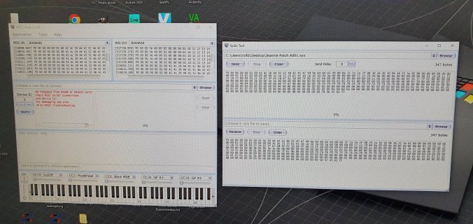

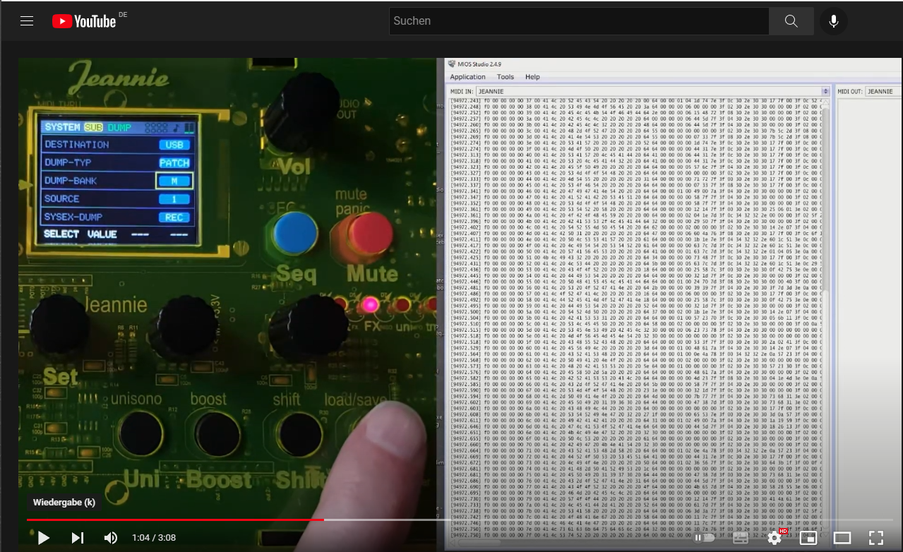

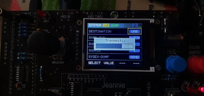

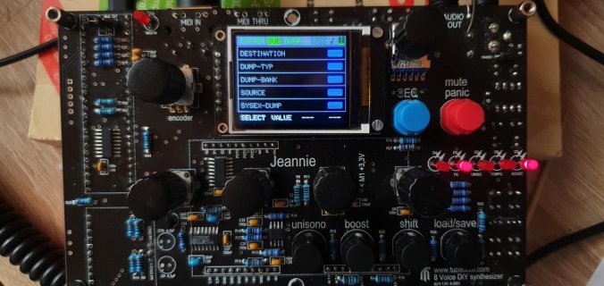

Small update..
Soon there will be SysEx DUMP for Jeannie. Then nothing stands in the way of the patch exchange.
The transmission path is selected with DESTINATION, eg Midi or USB
DUMP TYPE selects a patch, bank, or all
With DUMP-Bank the bank
With source the patch
With SYSEX-DUMP transmission to the PC or reception
Transmission or reception is then initialized via the load/save button
Sending and receiving from SysEx already works. But I still have to do some programming :cool:
Never ending programming. Greetings, Rolf

SysEx Dump works now. See short video.
It was a bit more complicated than I thought. First, conversion routines had to be developed for all 212 parameter values in the Jeannie, which convert 8/16-bit integer values and 32-bit floating-point values into a 7-bit format for the SysEx dump. The same had to be converted back again.
This was followed by functions for the transmission and reception of SysEx data. Last but not least, a simple menu for operation had to be developed.
The transmission path is selected with Destination (Midi or USB)
DUMP type is either a patch or a bank.
DUMP-Bank sets the bank (A-P) for transmission or reception.
Source is either the patch no. or when receiving the space in the selected patch bank.
SYSEX-DUMP is set to send or receive SysEX data.
The "Load/Save" button starts transmission or reception.
A progress bar shows the progress of the transfer.
Video: https://youtu.be/xRoLsR9HgU0
Greetings Rolf

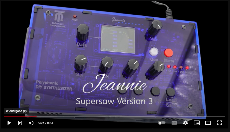

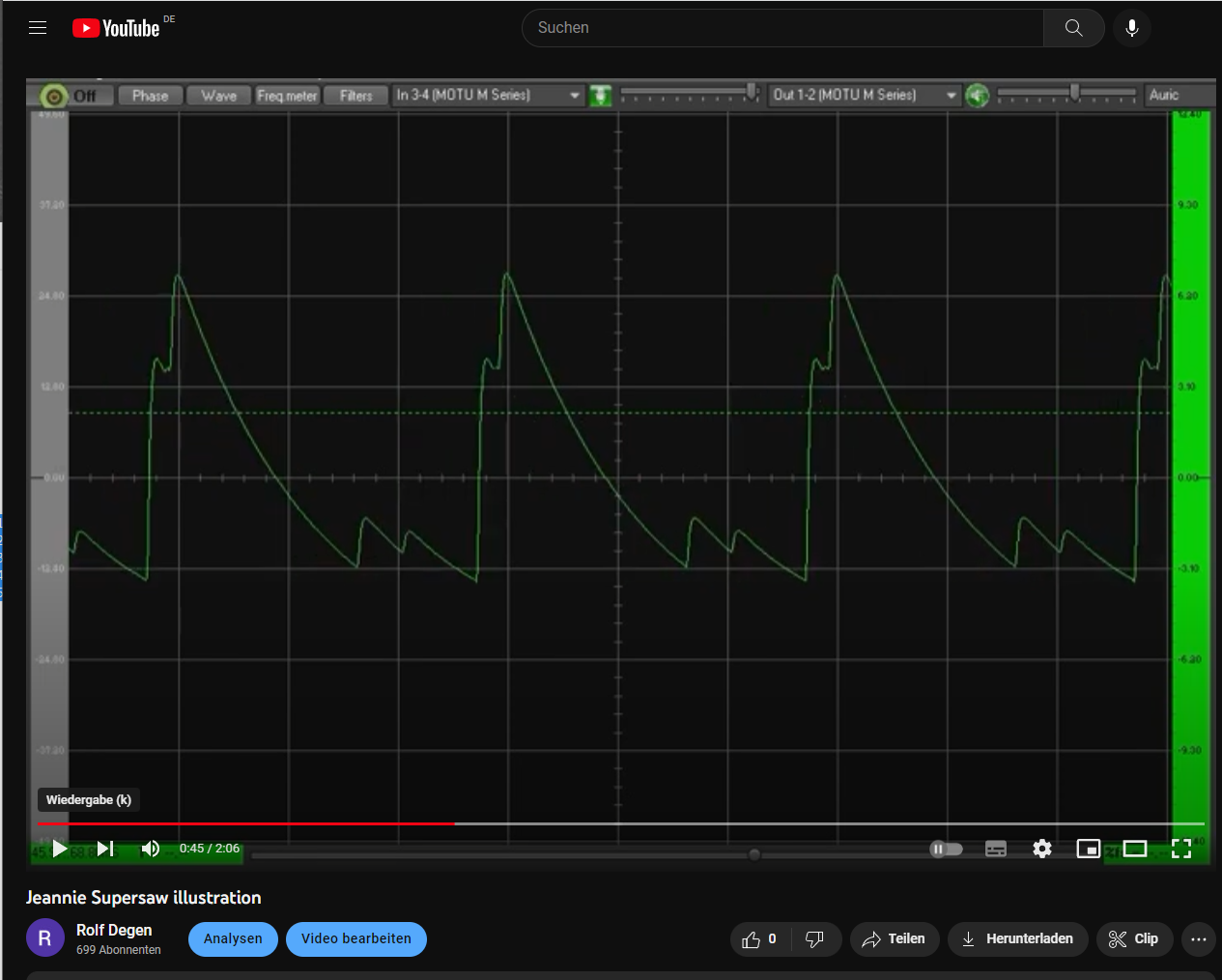

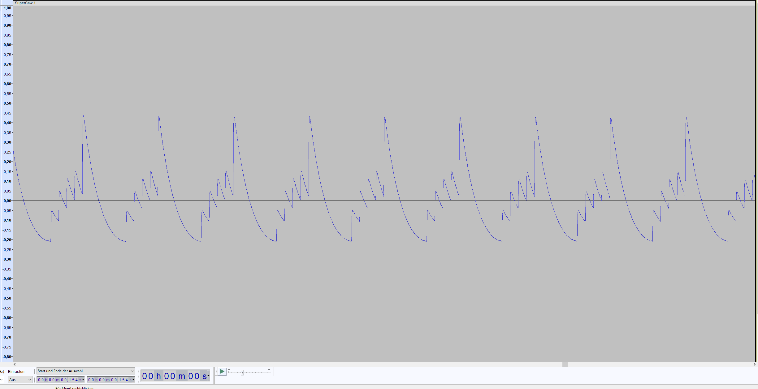

I'm still in the process of integrating a SuperSaw into the Jeannie. 6 saw teeth per oscillator. This corresponds to 12 per vote.
Unfortunately, the whole thing doesn't sound right yet. Below is the source code and an audio sample with an oscillator.
Maybe someone has an idea about it ?
Supersaw with small spread value (saw_inc32)
Audio Link: https://www.sequencer.de/synthesizer/data/audio/149/149083-8c02e58a5ebdd1b6504b537ab2cc5d59.mp3
My Supersaw waveform code
// Phase increment for SupperSaw
saw_inc32 += 6378593;
case WAVEFORM_SUPERSAW:
for (i=0; i < AUDIO_BLOCK_SAMPLES; i++) {
uint32_t ph_1 = phasedata[i];
uint32_t ph_2 = ph_1 + (saw_inc32 * 1);
uint32_t ph_3 = ph_1 + (saw_inc32 * 2);
uint32_t ph_4 = ph_1 + (saw_inc32 * 3);
uint32_t ph_5 = ph_1 + (saw_inc32 * 4);
int16_t val_1 = signed_multiply_32x16t(magnitude * 0.40f, ph_1);
int16_t val_2 = signed_multiply_32x16t(magnitude * 0.15f, ph_2);
int16_t val_3 = signed_multiply_32x16t(magnitude * 0.15f, ph_3);
int16_t val_4 = signed_multiply_32x16t(magnitude * 0.15f, ph_4);
int16_t val_5 = signed_multiply_32x16t(magnitude * 0.15F, ph_5);
*bp++ = val_1 + val_2 + val_3 + val_4 + val_5;
Oscillator from Teensy Audio Lib

The Supersaw is generated in the Jeannie with an oscillator. The fundamental wave is a rising sawtooth calculated in real time by a phase register. I use the phase register to calculate additional (four) sawtooths and add them to the fundamental via an addition.
// Supersaw
        case WAVEFORM_SAWTOOTH:
            saw_inc32 += 2039 * SupersawSpreadA;
            uint32_t spread_2 = saw_inc32;
            uint32_t spread_3 = saw_inc32 << 1;
            uint32_t spread_4 = saw_inc32 << 2;
            uint32_t spread_5 = saw_inc32 << 3;
            uint32_t ph_2 = (ph_1 + spread_2);
            uint32_t ph_3 = (ph_1 + spread_3) >> 1;
            uint32_t ph_4 = (ph_1 + spread_4) >> 2;
            uint32_t ph_5 = (ph_1 + spread_5) >> 3;
            int16_t val_1 = signed_multiply_32x16t(magnitude * Supersaw_gain1A, ph_1);
            int16_t val_2 = signed_multiply_32x16t(magnitude * Supersaw_gain2A, ph_2);
            int16_t val_3 = signed_multiply_32x16t(magnitude * Supersaw_gain2A, ph_3);
            int16_t val_4 = signed_multiply_32x16t(magnitude * Supersaw_gain2A, ph_4);
            int16_t val_5 = signed_multiply_32x16t(magnitude * Supersaw_gain2A, ph_5);
The Supersaw in the Jeannie now works well. I fixed a few more bugs in the code.

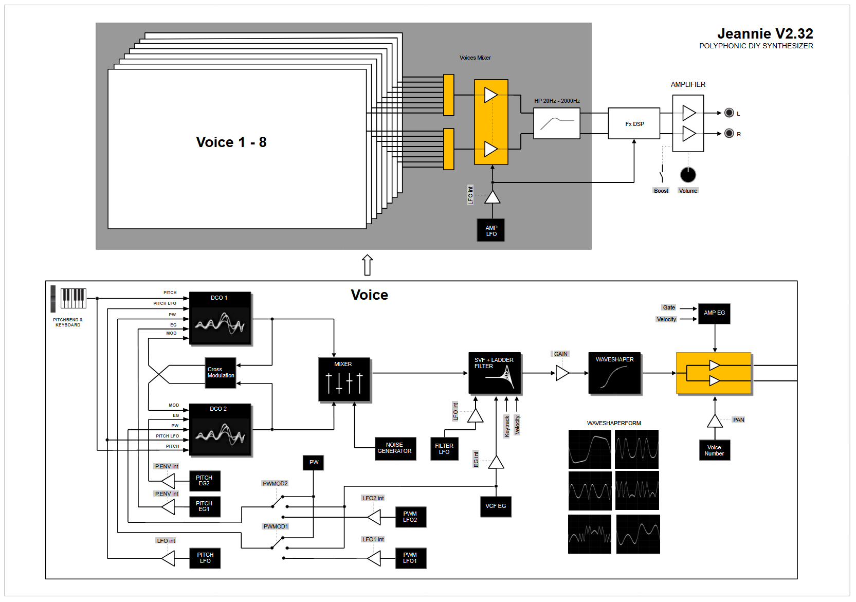

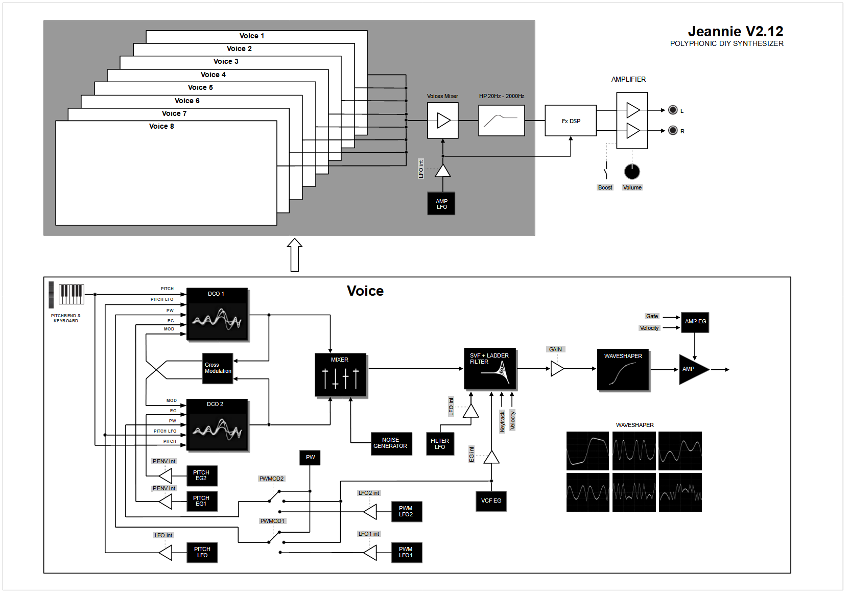

After the many additional features we drew a new block diagram of Jeannie.
Sounds and looks great as always! Thanks for sharing the architecture, food for thought.
Any thoughts on a hybrid design with analog VCO/VCF/VCF and Teensy control?
