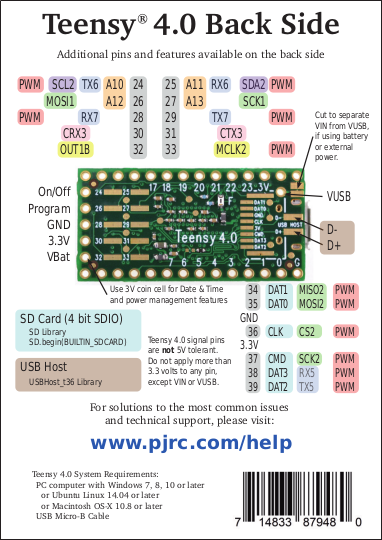

I'm using every pin on the Teensy 4.0. Perhaps it would be better to switch to a second Teensy 4.1. Then a high-speed SPI connection between the first Teensy (audio engine) and the second Teensy (GUI) would be possible and I would have a few GPIOs free for future features :unsure:
Even the Bottom pins? The small end pads look to have SPI2 34-37
And the D+ and D- give USB_Host. Though T_4.1 as Host could treat T_4.0 as a device and give USB Serial connect for best speed, just lose easy connect to the PC to program without cable swap or maybe FlasherX.
