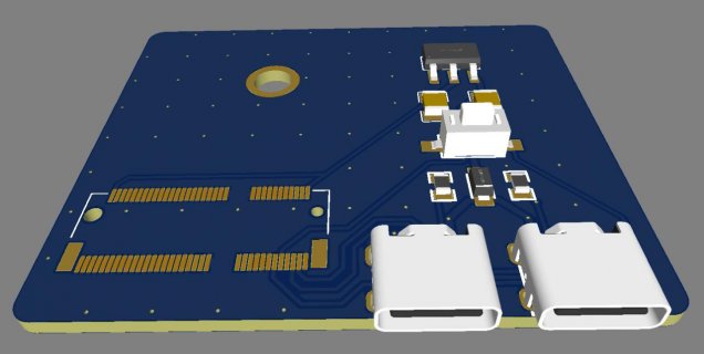

@brtaylor thanks for stepping up to help! There is Kurt's mapping here and Sparkfun's mapping here under MicroMod Pinout

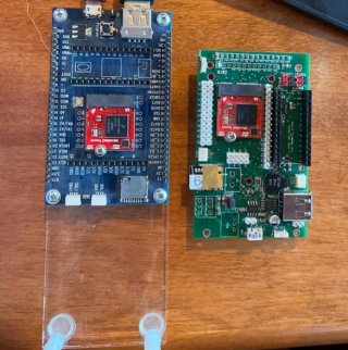

Just to be clear, you have to ground all the GPIOs on the ATP.
I've done this with a set of male pin headers all soldered together, connected to ground, and inserted into the relevant female header on the ATP board.

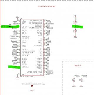

So far, your program is just reporting Pin 22 and Pin 28 as high. Looking at this image, I can't find those on the ATP board:
https://forum.pjrc.com/attachment.php?attachmentid=25533&d=1628355409
Pin 22 I believe is MMOD pin 49 (BATT_VIN3)
Pin 28 is MMOD 4 (3V Enable pin I think)

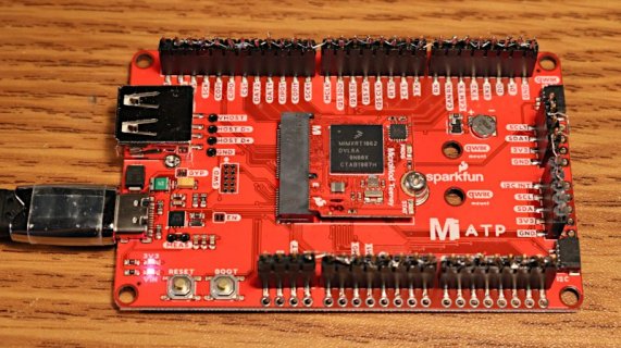

I wired all the ATP pins to GND and ran it here on both MicroMod boards on my workbench.

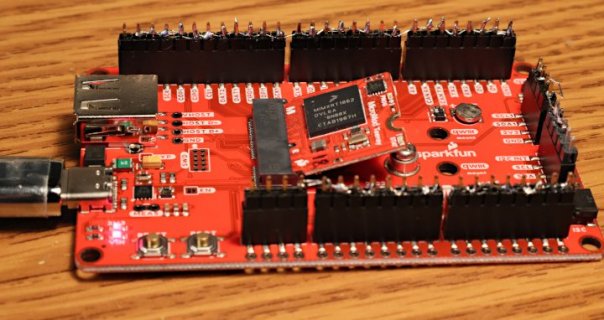

Did you fully seat the MicroMod on the M.2 connector (so it is parallel to the board), or did you leave it tilted like that? Perhaps the PCB material flexes too much on some of the M.2 connectors, causing the connection issues?
(Granted, I'm too lazy to check where the affected balls are, so I'm definitely just guessing here.)
I, too, will be getting a Teensy MicroMod soon (it is on its way from BerryBase.de via a friend), but I don't have the baseboard yet; I'm going to use it with my parallel ILI9341 display module.
I tested with the card tilted, exactly as you see in the photo. I too was lazy about using a screwdriver to secure it. ;)
Ok, ran the test again on both boards, this time using the screw to hold them done.
Exactly the same result, 1s on pin 22 & 28 and 0s on all other pins.
Pins set to input
Pin 22 state: 1
Pin 28 state: 1
Test Completed
Pins set to input
Pin 22 state: 1
Pin 28 state: 1
Test Completed
Again, does not surprise me. Paul - would be better with your own board!
As I mentioned,
Where the Enable is one one side or the other of jumper

I have just drawn up a test PCB which will be ordered ASAP, this will make it super easy for me to test all the Micromods I order.

And I rang out all of the IO pins on it and it, all were found.
Note the green board is my own breakout, that I had partially assembled. Earlier I rang out all of the pins on that one.
There is another older thread where some fewer intermittent issues were noted. I got out a new one or two {from early production} and had some odd pins - but they went away swapping across boards so none seemed faulty in the end.
