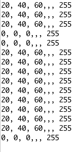

Only thing I noticed is that while testing I often plug and unplug the DMX cable to test my receive indicator. Depending on where I am in the packet when I unplug, sometimes my next read shows all zeros. It's not a problem for me, but wanted to mention it.

Can you tell me more about what happens when you unplug the DMX and you get all zeros? Curious, are you checking the length returned by readPacket()?

Basically I'm storing the whole packet, then printing the first three, then the last value. This was so I could double check I was receiving the correct values where I thought they should be. No issues there.
Attached (hopefully) is a screenshot of my serial monitor. The two anomalous areas you see are where I unplugged the XLR, then replugged, then unplugged again.
Like I said, I think it's based on when in the packet I happened to unplug. It isn't a huge deal for my purposes at the moment. In the future I'll probably put in a timeout that zeros the buffer if it detects a drop in DMX.
Let me know if the image didn't work, I will try to attach again.

jkoffman: Curious what the 'read' value is when receiving a packet. It will return the number of bytes actually read, up to and including the given length. Maybe the received packet, in the case of a disconnected cable in the middle of one, is actually much smaller?
@jkoffman: I believe I have a fix for the all-zeros issue. Let me know if you have some time to test a new branch.

I just released v2.3.0 that contains better handling of packet boundaries and timeouts. I *think* this may solve @jkoffman's "unplugging problem".
