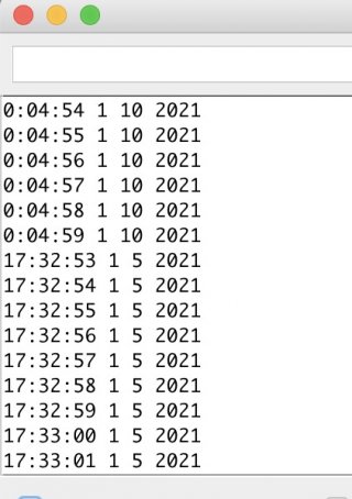

I tried to recompile and download and worked only once!
Tried with Teensy 3.2 (no Xtal) AND Teensy 3.6 (Xtal factory installed ):
1: download TimeTeensy3.ino on the serial monitor you get the time displayed. If you remove the power and set the power again the time restart at the same time after download.
2. added: setTime(0,0,0,1,10,21); into the setup:
void setup()  {
  // set the Time library to use Teensy 3.0's RTC to keep time
  while (!Serial);  // Wait for Arduino Serial Monitor to open
  delay(100);
  if (timeStatus()!= timeSet) {
    Serial.println("Unable to sync with the RTC");
    Serial.println("RTC has set the system time");
Just after download you get 0:00:00 1 10 2021
it correct!
Let's running for a while...
After 5 minutes you get the old time again!!!!!
Exactly the same behavior with Teensy 3.2 and 3.6
Why is it so difficult to set the time????
I think the easiest way to get you to understand what is happening is to ask you
what
does?
I think you are confused how this Tme Library works. See Time Library: https://www.pjrc.com/teensy/td_libs_Time.html
It's just basically software clock implementation with easy to use commands, Internally, Time depends upon Arduino's millis() function to keep track to elasped time. However, Time can synchronize to several types of hardware which provide time and date information.

    [COLOR="#FF0000"]setTime( Hr, Min, Sec, Dy, Mnth, Yr); // Set Arduino Time library.[/COLOR]
    Serial.println("Seting the Teensy RTC Clock from Arduino Time library");
    // Now lets set the RTC in Teensy before exiting.
    // Now we can use the system time to update the Teensy's RTC bits
    // This sets the Teensy RTC Clock from Arduino Time library(system time) - epoch stylee, just like it wants :)
    [COLOR="#FF0000"]Teensy3Clock.set(now());[/COLOR]

Each time a program is compiled and loaded to the teensy the date and time from the PC is embedded into the teensy SetUp/StartUp code.
This code is run each time you apply power to your teensy. So, unless you have an RTC running, you will ALLWAYS get the SAME date/time.
The program TimeTeensy3.ino is built to take an input from the USB Serial Port to set the computer date/time.
I believe the input to be sent is in the form Tyr,mo,dy,hr,min,sec where T is a header to say that time set code follows. You WILL SEE this if you examine the program.
