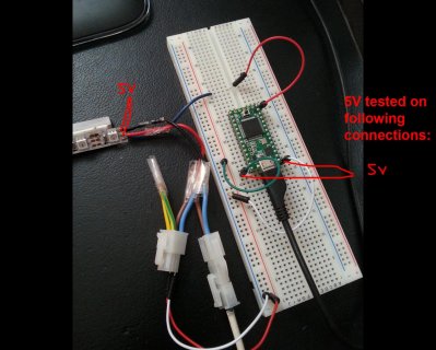

I have ws2811 LED strip of 28 leds. Only data, ground and live wire.
trying to play around with them but when I load a sketch provided in the forums for NeoPixel library "strandtest" sketch nothing happens.
Here is my setup:
-cut connection between USB and Vin due to LED strip requiring 5v input.
-temporary connected USB and Vin to upload a proper sketch (without connection it doesn't upload, right?)
-my 5v 30A power supply has been connected to LED strip
-LED strip ground wire connected to Teensy ground pin
-LED data wire (no clock wire) connected to Teensy pin 12
when sketch is uploaded nothing happens. Do I need to connect powersupply V to Teensy Vin pin as well?
I tried it with and without powersupply live wire connected to Vin but still nothing happens.
Sketch in questions is:
If I load a Teensy example Blink sketch Teensy LED blinks so the upload part on my computer is working properly.
Any help is appreciated.
