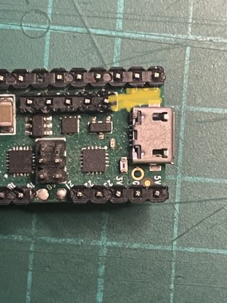

looking at the board, how about adding 2 extra pins to the host connector? it seems like there would be space there next to the USB socket

If the board offered a creative place for two pins Paul would find it. Don't forget it is also using the longer USB-C connector so even that room wouldn't be there if a T_4,x were configured for that to fit.
