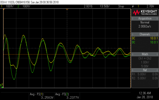

Agree. But it does actually work. The RME ADI-2 Pro FS does recognize the RCA signal [using an SPDIF coax/optical breakout board with 220Ω/100Ω divider]:
However, when I built the 4K7/1K divider + capacitor circuit from the first post, the RME does not recognize the signal.
The oscilloscope shows that the signal is too small:
I did use a 75Ω load on the scope input.

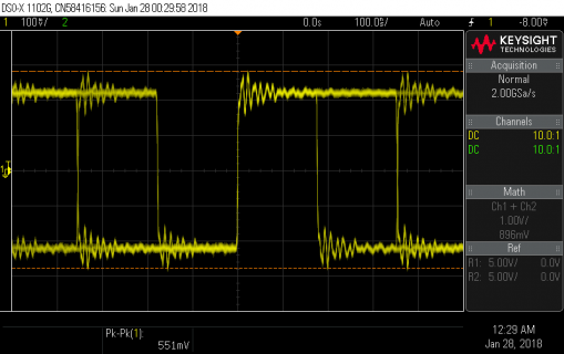

After some more fiddling around, I finally settled on a 2.2uF capacitor followed by a 470 ohm resistor. (I removed the 1k resistor completely.) Testing with a 75 ohm load gives us a comfortable 0.55 V peak to peak (loaded), and drops the current close to 2mA (measured across a 10 ohm shunt resistor).
I also discovered that the cheap DAC I bought was overloading the circuit.
There are probably ways to optimize this further, but I think it's safe to call it good enough for the time being.
