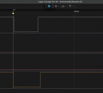

However, when I use the SPI, see attached a DigPot control sketch, I get no SCK and nothing on the MOSI that means anything. Please I am not sure that the CS pin is doing what it should be doing either.

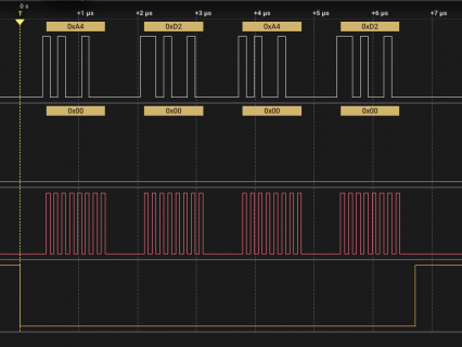

  • BitBangTestOfSPI.ino
  • BasicDigPotSPIControl.ino

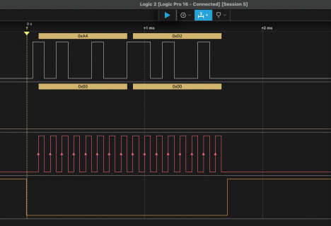

I have now tried to run SPI
MOSI (Pin11) - White trace
MISO (Pin12) - Brown trace
SCK (Pin13) - Red trace
CS (Pin10) - Orange trace
And I get the same result, no SCK or MOSI, and a strange CS trace!!! However, the bit-bang works and so the pins are connected correctly.

It is not a case of it not quite working, there is just no SCK at all.
I have even written a direct LPSPI sketch, but I get the same issue; no clock.
I have rolled back to 1.58.2, 1.59.0, updated the Arduino IDE to 2.3.8, made sure that the path to the SPI library is correct and that it is using the __IMXRT1062__ and ARDUINO_TEENSY41
But nothing on SCK

If I use SPI_MODE0 or SPI_MODE2 it does not hang, but clearly does not work. Interestingly SPI_MODE3 hangs too.
Using SPI_MODE0, I get very nice logic on both MISO and MOSI, SCK is good form and CS is going LOW as expected.
All as expected as I have all the other devices working.

Change SPI_MODE1 to SPI_MODE0 or SPI_MODE2 and it does not hang.
And I get the correct output on the logic analyser.

Note that if I change the SPI.beginTransaction to SPI_MODE1 for the other devices, then it will hang.
I have double checked every pin can toggle correctly by having a dedicated sketch and using the logic analyser on each pin on the SPI bus and each of the CS pins.
