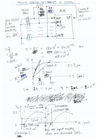

Kalo, I agree, it would be a shame if Teensy 3.x is discontinued forever. But it is certainly possible to implement touch sensing on MCUs without hardware support, using only one resistor per touch-pad! The MCU must have I/O pins that can be configured as either analog inputs or logic GPIO. (What MCU doesn't these days? -- Most do.) Also, the application must be able to tolerate a short delay (no more than 10 microseconds), periodically, with all interrupts dsiabled. So it's "almost" non-blocking. The method is very similar to that used by the CTMU (charge time measurement unit) in some of the PIC family MCUs, e.g. PIC18FxxK22, which I have used in another project. Actually, CTMU is a misnomer, because the "charge time" is constant! The ADC measures the voltage on the touch-pad input at the end of the (constant) charge time. Of course the charge rate, hence measured voltage, will vary depending on the capacitance to ground. I have not so far documented the method or tested it, but I will do so and publish the document somewhere. Meanwhile, see attached scribble which I did a while back. I hope you can make some sense of it.

Cool input :) .. thank you Lalbert ! .. i might need some time to get all details, lol. Anyhow, i got your general idea .. so yes, could be an option, but it is still a pity that the PJRC team decided to go without Tocuh Pins in moment. No idea why. And i hope they will rethink again .. and producing any next Teensy updates with Touch Pins back.

Anyhow, no worries... I have successfully tested a technique to implement touch-sense on a micro-controller without on-chip touch-sense hardware (ATmega328p, as found in Arduino Uno, Nano, etc). I am not claiming originality for this technique, but I have not seen it described anywhere.
The scheme requires one resistor and one diode for each touch-pad. The idea is based on the operation of the "CTMU" module found in some PIC18 devices. The CTMU is not necessary... its function can be replicated in software with the aid of a timer/counter peripheral, without causing excessive delays to other tasks. (The touch-sense "service routine" takes less than 30 microseconds per touch input.)
If your chosen MCU does not have enough ADC inputs for the required number of pads, then maybe an analog multiplexer chip could be used, or upgrade to an MCU with more ADC inputs!
When I finish documenting the technique, I will post it on various sites, including my own website, GitHub, and Elektor Labs. I'll also post a link on this forum for you guys.
