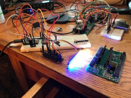

@all.
I have better case now for level shifter using propshield... Working better. I have updated the two examples plus readme.md file, fixed Pin 17...
Tried on the valid pins on standard outer pins as using breadboard. Will try others later.
I went ahead and issued PR: https://github.com/PaulStoffregen/WS2812Serial/pull/8
Note, I didn't bother with the level shifter, I just powered the two neopixels from 3.3v as these rings seem to be ok with 3.3v. Maybe it tripped the fuse. I need to get off to work. Tonight, I'll break out a level shifter and use 5v tonight. But the Teensy 3.6 ran with the same setup past where the Teensy 4.0 hangs.
Thanks @MichaelMeissner.
I moved the setup to the FRDM (with USB) board, which is plugged into breadboard and tested the other pins, and they appear to work as well.
This is including 39 which is an alternate pin in Serial5. The only alternate Serial TX pin...

As I suspected earlier, when I saw the lock up, with the pixelss all plugged into 3.3v, it was just about to display white (0xff, 0xff, and 0xff) to all 64 pixels (i.e. all white at maximum intensity). That is what caused the Teensy 4.0 to lock up. Presumably, this was due to the fuse being triggered. I attached a SN74HCT125N and used the 5v directly from the USB to power the LEDs, it worked fine.
I was curious, and I put a USB voltmeter/ammeter on the USB connection, it read about 1.2 amps (at 5v) when it was displaying all white at maximum intensity. This matches up with the specs that say the pixels will consume ~18-20 mA per pixel at maximum brightness.
I forgot about the large power draw, since I always limit the max for R + G + B to be no more than 30 (i.e. white would be 10 + 10 + 10). This allows me to run a pair of goggles using the 2 32-pixel rings at 75 mA. But in this case, I was taking the example from the WS2812Serial library.
