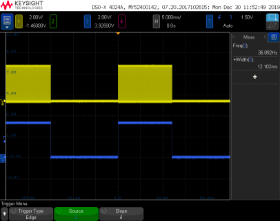

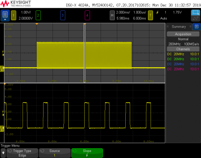

I'm using a Teensy 3.2 with the pjrc library 'WS2812,' and was able to reproduce my problem with only the example codes. I'm running Teensyduino 1.4.8 on Arduino 1.8.9
I have added a few lines of code to time the 'leds.show()' function as well as report it to the console, and an additional delay (typically not necessary) to be absolutely sure the function is not getting called too fast (I know it will stall if the previous transfer is incomplete). I also changed the number of LEDs from 64 to 384, the number I am working with. Otherwise the example is unmodified, and my strip of lights still animates as expected (the extra delay slows the animation slightly).
I am seeing a return time that depends on the number of leds (!!), and that gets as high as 1200us with 384 leds (the number I am working with), but is still as high as 200us with 64 leds (the default).
I have found this blocking time changes by as much as a factor of 2 based on the compile options (384 leds ranges from 600us to 1200us), though I don't pretend to really know what those options are changing.
When I hacked up the library to add a bunch of intermediary timer variables, it looked like all the time was spent during the phase denoted
. The rest of the steps added up to less than 8uS.
I guess that means this is a soft blocking function, since I'd still be able to interrupt it during that time, which makes it more useful than other neopixel libraries, but it still caught me a little off guard that the leds.show() function takes nearly as long to return as other common neopixel libraries (it's a few times faster).
I guess what I'm trying to ask is: is this delay a hard limitation of the library? Would it be feasible to do the buffer copy in the background, a bit at a time?
// copy drawing buffer to frame buffer
