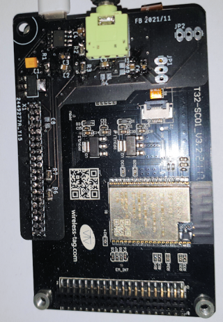

Oh my... If you keep this up, you'll make me bring out the Teensy again :)... I hope I can hold off until the weekend...
My radio works very reliable now (playing 48k 256kbsp AAC stream without any glitch for 12 hrs now, stream is psram-buffered), but still on a blank screen and I still have to edit the sourcecode to change the station...
(The upper board is (c) Frank B. :) - next revision will have the parts on the backside - total height with cap touch 320*480 display .incl will then be like a Teensy with pins. And it will have a SD-Slot.
