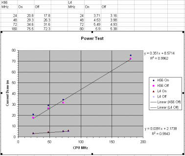

onto both the K66 and L4 and measured the current required to run with both the led on and off while changing the CPU clock speed in the IDE. This is a very simple test of the native power usage when there is very low demand on the MCU resources but all MCU peripherals active by default contribute to the power usage. Here is the results:
The difference on vs. off in each case is simply a matter of which current limiting resistor and color of led was chosen, the useful comparison is with led off. Here you can see that the K66 is using ~350 microAmp per MHz CPU speed while the L4 is using ~39 microAmp per MHz, one-ninth the slope (the actual power usage difference is less) to perform the same task(s). Of course, the tasks aren't exactly the same and that is partly the point, both MCUs are busy doing a lot of things not needed for this particular application. But the L4 has been designed by ST to minimize the number of these tasks, the power each draws, and allows the user (as does the K66 to a degree) to configure the MCU to lower power even further.
So what? If you want to use an MCU to control a megawatt string of leds, you won't care about the power drawn by the MCU! But if you have portable, remote and/or wearable applications running from a small LiPo battery (like almost all of my applications), then MCU power usage is critical. A typical small application uses a 110 mAH LiPo battery for the smallest form factor. This will last ~20 hours, 2.5 eight-hour days, when using the L4 MCU running at 72 MHz continuously (perhaps less when we add sensors, etc). The K66 will last ~3 hours. For some applications, recharging often is no big deal, for others it makes all the difference. But this is why low power can matter.

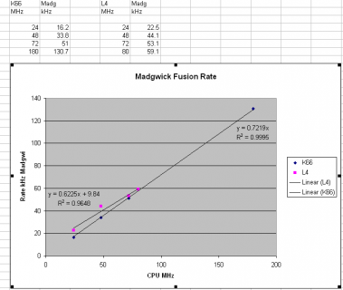

Next up is Madgwick sensor fusion filter rates, an excellent test of FPU performance.
Here are the results:
I ran very similar sketches (they can't be identical) using an interrupt-based data ready scheme with a MPU9250+MS5637 breakout board connected to pins 16/17 for I2C, 3V3 and GND and pin 9 for interrupt, as I usually do on the Teensy 3.2. For the STM32 I used an identical setup. The I2C bus was run at 400 kHz for both and apart from a few extra serial outputs for the L4, the sketches were functionally identical (I will claim).
The results compare well and I would say that both MCUs perform similarly. It is nice to see the fusion rate is linear with zero intercept with the K66 as I would expect (the rate being totally a function of raw processing speed) and gets up to the 130 kHz level, which is certainly overkill. Although I note the orientation solution was very stable at that rate. It is odd that the L4 fusion rate is less linear and that the best fit doesn't go through the origin. I will keep looking at this, but it might have to do with the extra gravity/linear acceleration calculations and subsequent serial output that doesn't appear in the Teensy sketch.
Overall I would say both of these FPUs perform well, and it is for computations like these that the 180 MHz of the K66 shines.

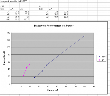

Lastly, how does the power usage scale with a more or less real world computational task? I have plotted the current measured vs. the Madgwick sensor fusion rate for both the K66 and L4 at different CPU speeds:
Now that the task is mostly FPU calculations rather than waiting in a delay, the power usages compare more closely. But note there is still about a factor of two difference in current usage for the same sensor fusion rate. I judge about ~7 mA is drawn to power just the MPU9250. So by reducing the accl/gyro rate from 200 Hz to 100 Hz and dropping the mag rate from 100 Hz to 8 Hz one can save some power. But power minimization isn't the point of this series of tests. Still, is it possible to lower the power usage on the K66 further? I don't know what kind of optimizations have been attempted already but I can say we have worked pretty hard to get the power usage down on the L4 in software beyond what the ST designers have already done in silicon.
It does not make sense to compare power-usage with the blink-example. In a real-wolrd application, where power-saving is essential, you'd never use a delay(5000) (a simple loop, internally) where the cpu jumps and jumps and jumps instead of going to a power-saving state with less MHz (or even ZERO MHz). I guess, at low speed, or stopped, the difference is much much less.
Btw, the second digitalWrite and delay in the posted code is superflues (as most lines in setup, too..)
Delay on the Teensy uses a simple busy loop, while the STM32L4 implementation puts the CPU to sleep, right?

Looks like I oughta use idle mode in delay(). Tried that on AVR years ago, but ran into hardware bugs with the ADC. Of course that's only Atmel AVR.
The STM32L4 uses wait-for-event (WFE) in delay which means, essentially, that the CPU enters a very low power mode automatically unless something is happening that warrants its attention. I don't know if something like this can be done on the K66. There are a lot of hardware architecture features that allow very low power usage with the STM32L4. We haven't enabled the very low power modes in earnest yet. The above results are for the full-on, normal power setting, where the only variable is CPU speed in the one (normal) power mode.
Are there low-power features built into the K66 architecture that could be brought to bear to reduce power usage? Even though 180 MHz is a fantastic capability, 80 mA is a lot of power to expend!
make sure you configure it for wait mode sleep (this would probably the equivalent to idle mode you are talking about) so any interrupt will wake it when using either wfe or wfi. In the T3.2 it saves about 3mA from run mode.
The simple test with delay(n) seems to be rather relevant. It simply gives a starting point to show the power consumption if really nothing is going on, and any more work you'd put onto the CPU would start adding more current draw from there. Same to adding more peripherals. From the datasheets the CPU contribution @80MHz should be around 10mA/3mA (RUN/SLEEP, all peripherals off) for STM32L476 and 35mA/24mA for K66 (numbers adjusted to 80MHz, from 120MHz listed, all peripherals off). If you compare Kris's graphs, that is reflected rather well, STM32L4 for SLEEP mode (around 5mA), and L66 for RUN mode at around 38mA. So I'd expected K66 to come in at about 26mA if one would use WFE/WFI type techniques. Perhaps @manitou could quickly test that (as I have no access to K66).
Then there is is notion of "yes, but real application don't just sit there and wait for 5 seconds". Well, many if not most of them do, actually. You wait for an I2C transmission to be done, or for sensor data to be read, or you wait for a chunk of data to be written to the SDCARD and so on. So there is a lot of waiting and an lot of transmitting data. All of this can be power optimized by putting the CPU to SLEEP rather than waiting around in RUN mode. So actually this "delay(5)" is a pretty good indicator for a typical application that does not require a lot of CPU horse power for computation only.
The other graph with Madgewick is what I find now utterly surprising. STM32L4 is about low power. It has a painfully slow FLASH interface, and in general is designed to be power-efficient, rather than fast (except USB-OTG, which is a powerhog and is slow). K66 on the other hand is designed to be fast and not really that power efficient. I would have expected the perf to be rather identical, unless either I/D cache misses put K66 at a disavdvantage, or I2C communication is more in the way than for STM32L4. In fact given that STM32L4 seems to be biased more towards power consumption, I would have not been surprised if STM32L4 would have been slower there.
Power consumption for the Madgewick test would be interesting, too. I'd oracle for STM32L4 about +7mA for the CPU being busy, +2mA for the internal bus interfaces, and +4mA for USB (if enabled) plus 3mA for MPU9250. So probably just a tad below 21mA. No idea where K66 would end up.

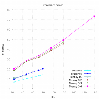

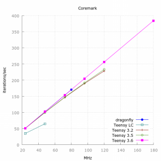

There are standard benchmarks for performance (DMIPS, COREMARK) and power usage (microA per MHz) each chip manufacturer touts for their products. What matters to me as a dummy Arduino user is that the same sensor management and sensor data fusion tasks can be achieved at the same rates but with half the power. I'll let the smart people figure out why.
At the bottom of this file: https://github.com/manitou48/DUEZoo/blob/master/perf.txt
are some coremarkish numbers for various MCU's including dragonfly and Teensy
For reference, another coremark-power plot for mbed LPC1768 or star otto-like mbed F469NI
Interestingly, the performance vs. power curves for Ladybug and Butterfly are even better since neither has a 16 MHz crystal and this consumes ~1 mA of power. In other words, I would expect the coremark numbers to be the same but the current usage to drop by 1 or 2 mA for these STM32L4 development boards.
