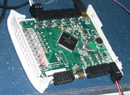

The Ring Management Unit (9S12 controller) has 5 CAN bus channels. Receives lamp information via USB and updates the lamps. Processors like the 9S12 in the RMU or PIC 18F2680s in the lamps have a decent IDE for developing, debugging and single stepping code or stopping a break points.
