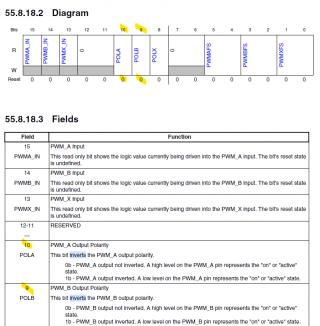

Thank you for your response. It is my understanding that setup level() would work great for a lower frequency. unfortunately I need to switch a GaN dual half bridge at 1mhz to both sides of a transformer and ultimately a piezo.. So, I need a way to set the bits in the picture below, while retaining the ability to add deadtime. Ive been able to do everything in eflexpwm that I need except switch those two bits for a submodule. I have tried to write directly to the registers and all attempts at that have resulted in no output. Thank you for your time and attention to this matter.

The level field sets those bits, and it's in the same channel data structure as the deadtime, so I don't understand what you mean when you say you can't set those flags. Have you experimented with the setupLevel() function?
