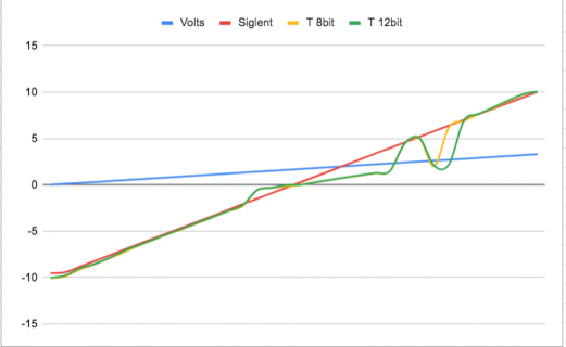

I am using Teensy 4.1's for my static Boeing 727 simulator which uses OEM parts and have run into an issue using opamps with the Teensy.
I have designed a circuit to use the 3.3 PWM output of a Teensy 4.1 channel to modulate a -10 to +10vdc signal using an opamp. I have attached the schematic for this circuit. Using a Siglent benchtop power supply, this circuit performs flawlessly; the output is linear and it is able to cover the -10 to +10vdc rails that are necessary for this application (see red line in graph).
When I use the teensy to drive the Opamp, however, the response is very erratic in the midrange. Today I mapped out this response in 0.1vdc increments from 0 to 3.3vdc (blue line) using the siglent as well a Teensy 4.1 set to 8 bit resolution (yellow line) as well as 12 bit resolution (green line). This occurs with both the Lm358 opamp as well as the Op2134. See attached graph to observe the distortion. I am not able to obtain -1.7v at all and the rest of the mid range and the big dip at upper range are not anomalies that I can code for. Does anyone have any suggestions?

PWM output is lacking a lowpass filter to create a DC voltage. Right now the circuit tries to convert a pulsed pwm signal from 0-3.3V range to -10 to +10V. What is measured is a chopped high frequency square wave using, presumably a dc voltage meter.
Texas Instruments has an app note about designing such circuits:
Still needs a properly designed low pass filter. Either before the scaling stage or in it (feedback capacitor) or even better using both.

Just a capacitor across C5 is necessary - that makes that opamp an integrator(*), and the integral of a digital signal is continuous.
Opamps don't respond to discrete input steps nicely, they expect voltages to be a continuous function of time. You can make the second stage an integrator as well to further filter out the digital PWM frequency and its harmonics, but its not essential to circuit function as it is for the first stage. A more common circuit topology is an RC-filter before the opamp input.
Note some opamps can even be destroyed by directly applying digital signals as they have input protection diodes between the inputs with limited current handling. In general opamps are operated with the two inputs at the same voltage.
(*) strictly speaking a bandwidth-limited integrator - a true integrator has only a capacitor for feedback, but that wouldn't have a defined output DC offset without extra reset-circuity.

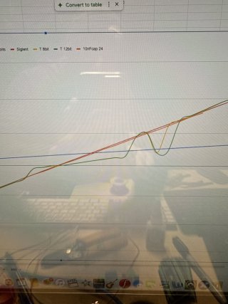

Thanks so much for you help with all this. Pio - your reference to that TI document was a lifesaver. I really like the circuit you've laid out and would go ahead and construct it if it werent for the fact that Im already way down the rabbit hole on the one I sent you - Im already on the fourth iteration of PCB's with it and it now has 6 channels on one board. The addition of the capacitor isnt a big deal since I can just bridge it across the appropriate resistor to salvage the PCB's I have already. I will keep this one handy if I reach the end of the rope on the current one for some reason and I really appreciate your help with this.
So today I was too impatient to wait for the 180pF capacitors to arrive so I took the lowest value capacitor I had lying around - 10nF- and went ahead and bridged the 23.9k resistor which is the feedback resistor of the first stage of the opamp (R5 - Mark - I think that is what you were referring to in your much appreciated note). Ive attached the curve. The green and yellow were without the capacitor and the orange is with it. You can see that the response is now linear and nearly follows that of the benchtop supply. Big sigh of relief here. When the 180pF ones arrive tomorrow Ill run the same test to see if there are any differences.

The value of the capacitor sets the cutoff frequency of the filter. With R5 = 23.9k and C = 10n the cutoff is at about 666Hz, which i think is ok, way below the PWM frequency. 180pF will shift it up to ~37kHz, thus, assuming the f_pwm is 4.5kHz or less, the filter will be just rounding off the edges of the PWM signal (=ineffective).
The ideal cutoff frequency would be the lowest value which is causing a still acceptable or non noticeable lag in the instrument display.
