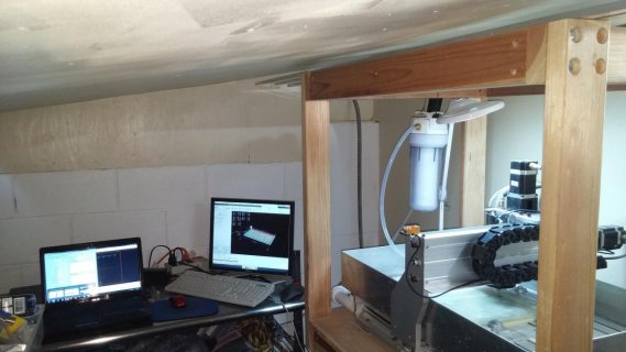

I own a little YooCNC 6040, which I retrofitted with new electronics and a water system for routing PCBs and G10 glass composites. I currently run LinuxCNC.

I also have a diy CNC machine which runs LinuxCNC and the openloop stepper drivers are simply connected to the parallel port.
For such external stepper drivers (in my case DQ860MA) a Teensy hardware board would essentially need enable-, step- and direction-terminals for each axis and some input terminals for the limit switches (24V prefered).
I can very well imagine that a Teensy hardware board could be produced universal for CNC machines as well as for 3D printers.
