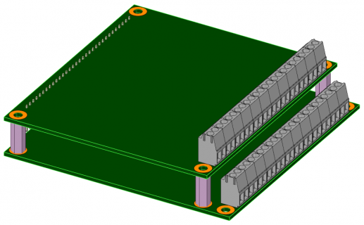

I've started the schematic and mechanical mounting layout.
Here is my current line of thinking:
Top board
The main board common to every scenario. It has:
- Size of 90x100mm
- Teensy 3.6
- Ethernet jack
- (6) Opto-isolated limit switch inputs
- Buck converter to reduce 12-48V down to 5 (or 3.3)
- TX/RX on screw terminals for pedants/external hardware
- (2) 5A outputs for general use (e.g. 3D printer would be hotend power & SSR drive signal for heated bed. CNC would be an enable/PWM signal for spindle)
- SIL header to bottom board
Bottom board
This is the application specific board.
Variant A: For a 3D printer, it would have all the stepper driver ICs on it.
Variant B: For a CNC mill with external drives, it would have the STEP/DIR output circuitry.
- Size of 100x100mm
- SIL socket for top board
The PCB sizes are specifically aimed at cheap PCB fab sizes (i.e. a max size of 100x100 means 10 boards for $13.50).

Ok, I understand you prefer Proteus, as you have climbed the learning curve... On the other hand I'd like the schematics and layouts to be open hardware. What about Eagle?
I have not done any serious PCB-design for some years, so I'll have to spend some learning anyway. I'm doing some tests with Eagle and it looks OK.
About your design : I like most of it, as it aligns very well with what I had in mind. I think the buck converter could be down to 5V as the Teensy has an on-board regulator down to 3.3V. I am currently thinking LM2596-5. I am also thinking about 8 (io. 6) opto-isolated inputs, as they come in Quads anyway. Could be a mix of limit-switches or other buttons.
I need to think about the need for 2 boards, even for a CNC with external steppers.
As this is the 'main' scenario I had in mind, I would like to have that on just 1 board.
So let me tink about all that and come back to you later.
Thanks for your contribution!

I would say that if we're both going to make the effort to learn something new, I'd say KiCad is the right option despite my struggle with it. (Just needs a new way of thinking)
This is almost entirely driven by these facts:
- The desire to have all the screw terminals along 1 face (makes this significantly easier to wire into machine cabinets when mounted on a DIN rail).
- The desire to keep the board size under 100x100.
(For example, 100x200 [the same area on 1 board] is $27.60 [so comparable to 2x $13.50] but locks the functionality into a specific format [i.e. CNC mill or 3D printing])

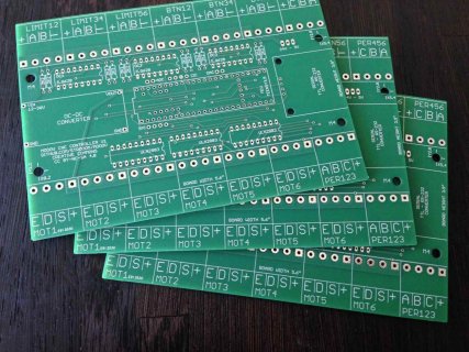

Just a quick update of the status : I've made some prototype versions of a PCB so I can move my testing onto real machines :
* 6 motors, 6 peripherals, 12 limit switches and/or buttons.
I will make the schematic and board-design available on Github.

I've found a few problems, such as obstruction of the USB and Serial connector from power-supply and drivers, but hey, that's why it's prototyping.
Nothing serious which can't be fixed easily in version 2.
