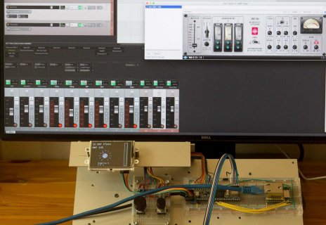

One of the issues with most commercially available control surfaces is the fact that they use the Mackie HUI or MCU MIDI protocol for communication. These protocols were designed to work with the 31kb/s midi bandwidth and as a result are limited when it comes to (text) feedback. On a Mackie control I often find myself guessing as to what it is I'm looking at. Open Sound Control (OSC) has none of these limitations but unfortunately OSC support is still rare. Reaper is one of the few DAWs offering comprehensive OSC support. To explore the available OSC interface I build a basic OSC controller.
A Teensy 3.6 with a WIZ820_SD_ADAPTOR and WIZ850io module for wired ethernet, the connections are as in the example for the WIZ adapter. Two rotary encoders, one (with the small knob, indented) for selecting a parameter and one (big knob, not indented) for changing the value. A 4D Systems display showing the track number and name, plugin name, parameter name and parameter value as string and virtual knob display. The display also has vu meter showing the track volume. Not shown are five button for navigating tracks and plugins.
