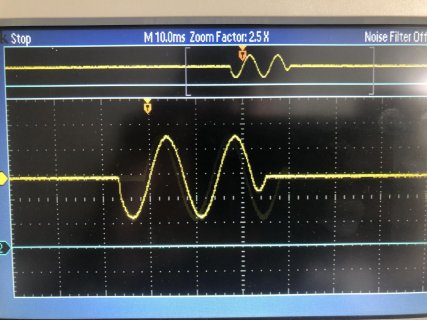

If we work in mono, things are fine. In the below example, the signal path is
Waveform1 --> Envelope1 --> pt8211:

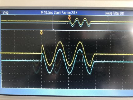

If we split the signal, so that it is output both right and left, things are fine too.
Waveform1 --> Envelope1 --> pt8211_left
____________________\----> pt8211_right
Things are still fine

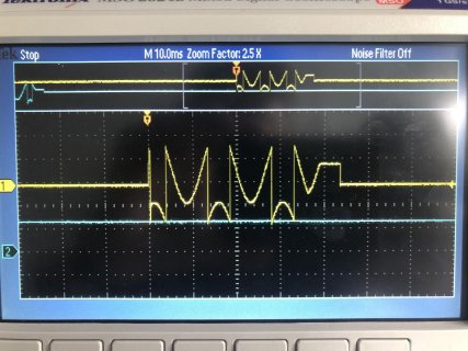

However, if we do a full stereo chain, things are very much not fine:
Waveform2 --> Envelope2 --> pt8211_right
I would expect to see the same waveform as shown in the other pictures in the top channel, and nothing in the bottom. Instead we get this;
We've removed all non-relevant bits of the code to create a super stripped down example, but still get this error.
I'm sharing the full code for reproducing this below. We tested this on Teensy 4.0 and Teensy 3.5 and get the same behavior.
Any recommendations on how to solve this are valued.
AudioSynthWaveform waveform1;
AudioEffectEnvelope envelope1;
AudioOutputPT8211 pt8211_1;
AudioConnection patchCord1(waveform1, envelope1);
AudioConnection patchCord2(envelope1, 0, pt8211_1, 0);
AudioConnection patchCord3(envelope1, 0, pt8211_1, 1);
AudioSynthWaveform waveform2;
AudioEffectEnvelope envelope2;
AudioConnection patchCord2(waveform1, envelope1);
AudioConnection patchCord1(waveform2, envelope2);
AudioConnection patchCord3(envelope1, 0, pt8211_1, 0);
AudioConnection patchCord4(envelope2, 0, pt8211_1, 1);
Full code for producing the overflow example:
