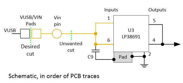

I know that while the Teensy schematics are available, you generally keep the Teensy PCB layouts proprietary.
However, I've recently hit a snag where I need to know the PCB layout in this region of Teensy 3.2:
... because I'm trying to understand a recent failure, and avoid it in future. So I'm hoping you might be willing to post just that piece (all layers), as it concerns an area of Teensy mods that is anticipated by the board design and docs (the cuttable VIN/VUSB pads).

I'm implementing a device that may be powered via Teensy's VIn (used as output), or may be powered by a separate 5V PSU (using Teensy's VIn as input).
The strategy is shown in this diagram. (click to enlarge)
Implemented by cutting the Vin/VUSB trace (as suggested in the pinout diagram), and adding a Schottky diode, as shown here.
Ultimately this worked fine, but not before the trouble described next...
After making the the mods shown, the Teensy did not power up from VUSB or VIN, which I discovered was because continuity was lost between U3-6&1/C9 and the rest of the net joining F1 and VIN pin.
I ended up adding the following jumper, and then things worked as intended (Teensy powers up from either USB or VIN, and there's no current path in the reverse direction through diode added across the cut pads).
This is on a fresh new Teensy that I had tested on USB before starting.
My hypotheses are that either:
Anyhow, at the moment I'm just looking for the PCB pattern of this neighborhood so I can think about this better, as the four items on that "VIN" net are not connected in the order shown in the schematic (nor would I necessarily expect that), and I' like to know the ground truth of what order they are actually connected in.
