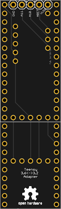

I have an idea: I can extend the Connectorboard a bit.. it would be more like a teensy 3.6<->3.2 adapter.. i post a pic this evening or tomorrow (have other things that want to be done at the moment :) )
Cool. I look forward to seeing it if you have the time to do it.
Hm, my idea does not work .. .)
Here's a very simple approach:
If anybody wants to buy it it will be ~6.50 for a set of four (thats around ~1.60 per board. usually, i get five ) from PCBs.io
Just let me know and I upload it.
I can add a simple power-on LED (through-hole, because its easier...)..
It looks good.

Hm, re: VSUB AREF, A10, and A11, they coud be placed as horizontal row between PIN 0 and VIN for 90-degree pin headers. I guess this does not hurt. And if yes, well, there's no must to solder them :)
Sounds reasonable, and it doesn't make the board bigger.
I'm not currently thinking about the secondary USB, but it may make sense to add another horizontal row to bring those pins out also.
That's a good idea.g
But i'll add it later, perhaps with a on-board USB jack connector - i want to check first which parts are good available (in Germany/Europe, too!) and not too expensive.

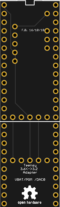

The board is here:
Edit:
https://pcbs.io/share/8gXO3
At the moment, untested (of course).
It looks like this:
The price is $6.63 (incl. shipping) - for a set of four boards ($1.66 per board)

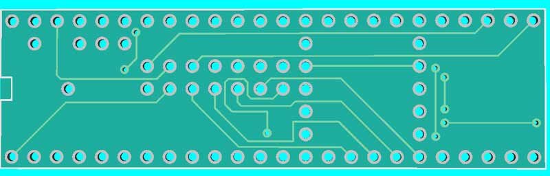

I hear you. For example I had a set of 4(or was it 5) made of my conversion board:
Which I had fabricated, which I have not tested yet either. The one difference was I tried to also map some of the additional IO pins for the T3.6, back into some of the internal pin locations for a T3.2, such that you could maybe use an older board with the T3.6. Again $6.70 for 4.

A big "sorry" - i did not notice that there is a problem with the eagle-library i used.
DON'T USE A HEADER FOR THE FIRST PIN ("5V") of the USB-CONNECTOR on T3.6 on this board.
I fear, the result will be harmful if you do so.. (but I have no schematic and can not verify this)
The mentioned lib connects it to VUSB, the autorouter connected both, and i did not notice it..
