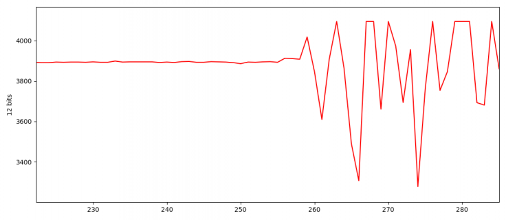

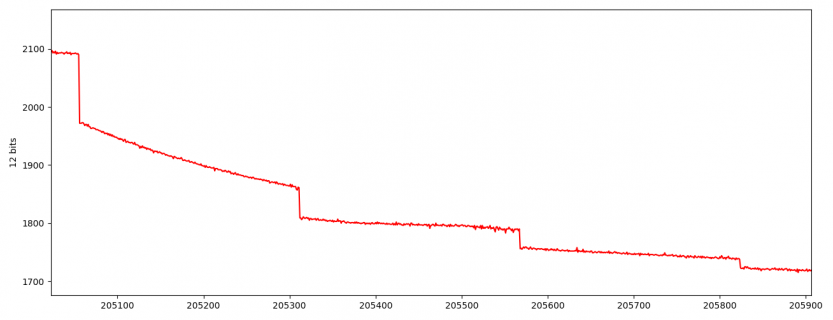

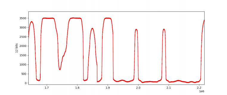

While looking for an adequate place for the patch, I noticed a strange pattern. First, here is the data flow:
ADC --DMA--> ADC buffer --> capture buffer w/recycling --> IIR HP (balancing) --> FIR LP w/subsampling
By writing samples to file at different stages, I observed below patterns (without patching):
Before IIR:
After IIR & Before FIR:
After FIR:
When DC offset (unbalanced) samples are leaked via recycling, and after IIR is applied to newly added samples, they become "remained above" samples. These recycled samples' count is about the length (taps) of the FIR filter, by input_adc.cpp design. And after FIR (with gain) is applied, they become sudden saturated samples that unwind quickly, forming the clicks.
Why recycling occasionally carries unbalanced samples? I don't know yet but it's probably related to SD card's actual write delays (~52 ms for me). Teensy audio system's update() call period is about 2.9 ms, which means about 18 update() calls to be missed during SD actual write operation. An update() call doesn't interrupt an executing update(), so this issue may be about DMA is wrapping ADC buffer several times. Discontinuities at before IIR image probably relates to this.
I'll try to increase ADC buffer size (and maybe capture buffer size as well) to mitigate this issue correctly. A quick try emerged consecutive restarts of Teensy. Obviously this alteration must be made by considering its effects comprehensively.
I tried with 128 and 2 GB SD cards, different classes, and observed different clicks. Their actual-write delays differ between 52 and 10 ms, respectively, and have different periods. Click periods alter accordingly.
P.S.: I'm still trying to use bigger adc & capture buffers, but Teensy keeps restarting continually. Maybe because of some memory addressing issue. I'll report back here when I managed to do that.
