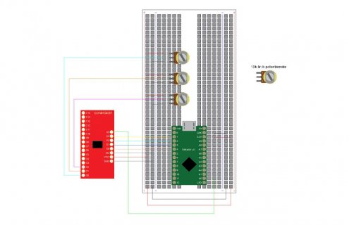

Here's how to make a USB midi controller for dirt cheap!
This controller has 16 analog inputs.
what you'll need:
1 Teensy LC ---> buy from pjrc ($11.65)
1 CD74HC4067 breakout board ---> buy from sparkfun ($4.95)
1 to 16 10k linear B potentiometers. ---> buy from ebay (5pc for $1.25)
1 Breadboard -----> buy from ebay ($1.50)
Wire....pennies per ft! buy lots because its always handy to have lots of.
Step 1:
Once you have all these items wire them up together like this...for simplicity sake only 3 potentiometers are shown but you can connect 16, just remember to connect any additional pots to +/- and the center pins of the potentiometers go to the "C" pins on the red breakout board.

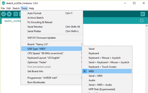

Open Arduino 1.8.4 and click "tools" and then set the board type to Teensy LC
Step 6:
Click tools and also set the USB type to MIDI
Step 7:

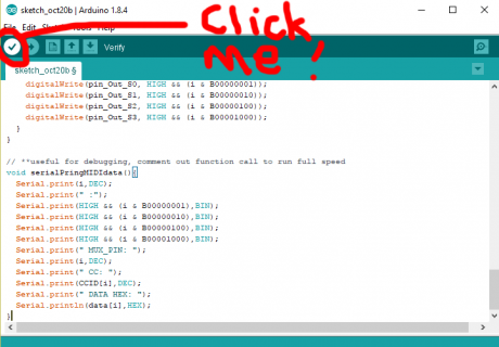

Click "verify"
Wait a little while and allow the arduino software to verify and compile the code.
Step 10:
Once its done compiling, click "upload"
Step 11:
Plug your fancy new DIY midi controller into whatevers you want and play around with it!

//************LIBRARIES USED**************
// include the ResponsiveAnalogRead library for analog smoothing
#include <ResponsiveAnalogRead.h>
//usbMIDI.h library is added automatically when code is compiled as a MIDI device
// ******CONSTANT VALUES********
// customize code behaviour here!
