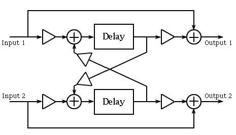

i started today patching audio objects to make a ping pong delay using the bottom grafic as inspiration. I also use external memory 23LC1024 RAM to get 1.5 seconds of delay time and my electric guitar as input.
At the end i sounds like a kind of ping peng pong delay... I like it...
Enjoy using it....
Enjoy using it....
