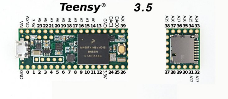

While we wait for the amazing 1170 chip, I'm considering making another Teensy4 with the same 1062 chip we have on Teensy 4.0, but in the Teensy 3.6 form factor.
So let's talk in this thread of which pins to (hypothetically) make available.

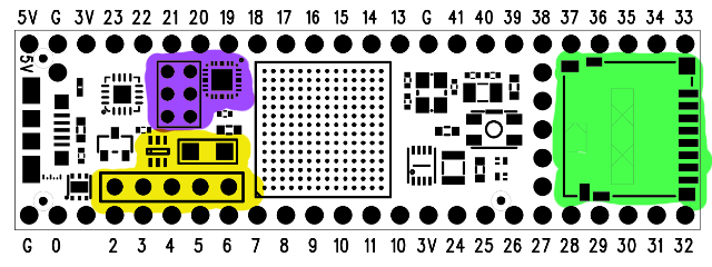

We would get 18 more pins on the outside edge, and maybe more on the bottom. Very likely the first 10 should be the same pins as we have on the bottom of Teensy 4.0? That would allow only 8 more pins. Or maybe all 18 could be chosen for this board. Only the 28 pins matching Teensy 4.0 have to be preserved.
These are all the unconnected pins on Teensy 4.0 which could become available:
I am considering putting an ethernet PHY chip on this board, with 6 pins/pads to connect another board having the magnetics and RJ45 connector. Or if a PHY chip isn't used, perhaps a high density connector with the RMII signals? Either way, I'm leaning towards reserving B1_04 to B1_11, and B1_14 & B1_15 for native ethernet.
Another feature I'm considering is using the bottom side for locations to add 1 or 2 QSPI memory chips, which could be either flash or psram. If that is done, pins EMC_22 to EMC_29 would likely be used. An alternative would be EMC_10 to EMC16, which supports only a single memory chip (only 1 chip select).
