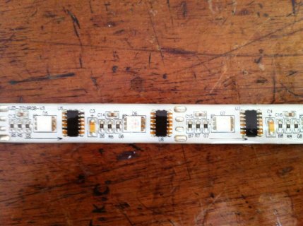

iainduncan, I did a quick mockup for low density WS2801 POV some time ago using fastLED as the library. The results were good for colour transformation and speed. At the time I decided to go with LPD6803 because of the form factor and density options. The image below is the test strip, just something I picked up to test the chip speed for image update rate, and the other shows the brightness of the ws2801 (i seem to remember that this strip used the 5050led, so brightness is the same as with other chip drivers using 5050). I decided to go with other options at the time as there was going to be too much in the way of soldering as there was not decent pre made form factor available.
Also, the ws2811 (eleven) are not good for POV. They update too slowly giving a speckled effect.
View attachment 2275View attachment 2276
