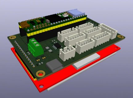

I have decided to use the touch function and the lcd function as well. I design some kind of shield / backpack for the teensy.
This is how it looks:

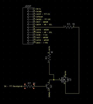

May I ask another question?
Is there a function to turn off the tft somehow?
To save a bit power. Or could I hook up the LED to a MOSFET and turn the LED off with a digital pin?
Or are there already built in methods to turn off the display?
Would like to prevent that colors could burn in. Or is it sufficient to just display no text?
I don't do as much as others here on the power management stuff, as most of the time I don't leave any of my boards running.... Just a hobby.
Software only you could clear the screen... But does nothing for power usage...
But more hardware/software wise, on some boards I have done, I have used a couple of transistors, that connect from an IO pin to the Backlight pin, which I first saw on a board by Frank B...
Note: some other higher priced displays, like ones from Adafruit may already have their backlight pin connected to one or more transistors.
With the backlight pin connected through a circuit like that you can then turn on and off the backlight by setting that IO pins value.
And if the pin you use for this has PWM capability you can use that to control it to dim it... For example I have one sketch that over time it steps down the brightness to just barely on, and if you touch the screen it brings it back to full value.
Thank you Kurt
Okay that I have guessed. Good Idea with the PWM pin. Thank you.
My dad is the electronics technician. I'm more the programmer :). Then I let do him this stuff and I do more the coding :).
He told me he would use a FET transistor instead of a normal one. But reason I don't remember actually.
From my diptrace file, my circuit is like:
Where I think Q2 was something like a digikey: BC850CLT1GOSCT-ND
and Q1 something like a BSS138CT-ND
But your mileage may differ. Also remember I am a software guy who dabbles with electronics. So trust your dad!
