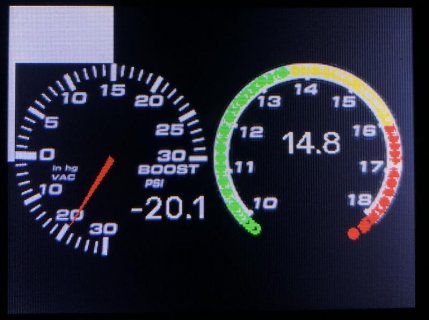

@KurtE, I'm seeing some odd behavior with the serClipRect.
I set the display background to white, then used your example code for the gauge and needle. I have another gauge image next to it with a slightly different form of indication.
When I clip and clear just the boost gauge (based on your code) - the entire screen is white besides the area surrounding the two images (as they have black backgrounds)
But when I set another clip area for the 2nd gauge, only a small portion of the display is white as can be seen in the image attached.
The 2nd clip is supposed to take care of the 2nd gauge but doesn't seem to be working as expected (not clearing the 2nd gauge)

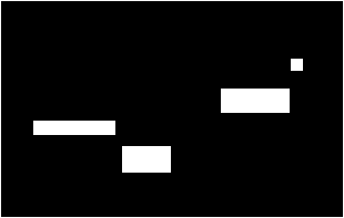

Just to make sure I understand this right.. looking at the image below - anything I load into the buffer will remain there unless I use the clip function to set and clear it (which would be the white boxes).
So the only place I would see a change is within these white boxes. Anything outside the boxes is pulled from the buffer and is unchanged.

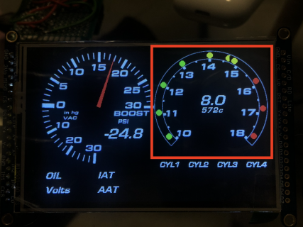

I'm facing an issue with the clip rectangle function on my second gauge.
For some reason its not clearing the previous drawing position. The only way I can clear it is if I clear the entire gauge face, which introduces more delay to the loop
Here is the code (used on the HX display, but exhibits the same behaviour on the ILI9341)

I was thinking, what if I draw a black circle on the previous location, then draw the coloured circle on the new location - that should clear the gauge properly?
Again in cases like this, if you have a small complete sketch, that runs, it would help for me to see it and maybe get an idea of what might be going on.
Otherwise it requires me to either try guess what is going on and/or fill in all of the gaps to make a compilable sketch.

Only reason I didn’t upload the full sketch is its about 500 lines long and has a bunch of peripherals that aren’t related to this specific function
I’ll put together a sketch tomorrow for the ILI9341 and upload it, Similar to the initial gauge sketch you wrote for me.
You might take a look to see if the changes I made in the post two up, fixes the issue for you?
What I do is simply to remember the last X, Y of where you draw the circle and generate a simple bounding box of the min and max of the current and previous position +-8 Note the 8, could be 7 and maybe 6... But I saw you started with 8 so...
Tested that out, it works well for clearing the "led" but it sometimes causes the strings in the middle of the gauge to flicker. I assume that your code basically draws a rectangle between the last position and the current position and clears anything inside of it, correct? And in that case, the clip covers the center of the gauge as well at times.
Another option is to do two update screens, one that covers the old position and one that covers the new position. like:
#include "HX8357_t3n.h"
#include "picture.c"
#define TFT_DC  9
#define TFT_CS 10
#define TFT_RST 8
#define DEBUG_PIN 7
HX8357_t3n tft = HX8357_t3n(TFT_CS, TFT_DC, TFT_RST);
uint16_t g2_center_x;
uint16_t g2_center_y;
uint16_t g2_offset_x;
uint16_t g2_offset_y;
  tft.begin();
  tft.setRotation(3);
  g2_center_x = 360 ; //center of afr gauge
  g2_center_y = 120; //center of afr gauge
  g2_offset_x = 240; // top left corner of afr gauge
  g2_offset_y = 0; // top left corner of afr gauge
  tft.fillScreen(HX8357_BLACK);
  tft.writeRect(g2_offset_x, g2_offset_y, 240, 240, (const uint16_t*)afr_240);
  tft.useFrameBuffer(true);
float airFuelRatio = 10.0;
float airFuleRatio_delta = .25;
uint16_t x_gauge_marker_prev = 0;
uint16_t y_gauge_marker_prev = 0;
uint16_t x_gauge_marker = 0x7fff;
uint16_t y_gauge_marker = 0x7fff;
  tft.writeRect(g2_offset_x, g2_offset_y, 240, 240, (const uint16_t*)afr_240); // afr gauge image
  ringMeter_n(airFuelRatio); // Value between 10 and 18
  tft.setClipRect(x_gauge_marker_prev - 7, y_gauge_marker_prev - 7, 14, 14);
  tft.updateScreen();
  // could maybe reduce but
  tft.setClipRect(x_gauge_marker - 7, y_gauge_marker - 7, 14, 14);
  tft.updateScreen();
  tft.setClipRect();
  airFuelRatio += airFuleRatio_delta;
  if (airFuelRatio > 18.0) {
    airFuelRatio = 18.0;
    airFuleRatio_delta = -airFuleRatio_delta;
  if (airFuelRatio < 10.0) {
  delay(250);
void ringMeter_n(float value) {
  int r = 110;
  value = constrain(value, 10, 18);
  int v = map(value, 10, 18, 15, 85); // Map the value to an angle v
  int led_color;
  // save the last one
  x_gauge_marker_prev = x_gauge_marker;
  y_gauge_marker_prev = y_gauge_marker;
  double rads = HALF_PI + TWO_PI * v * 0.01;
  x_gauge_marker = cos(rads) * r + g2_center_x;
  y_gauge_marker = sin(rads) * r + g2_center_y;
  if (value < 13.50 ) {
    led_color = HX8357_GREEN;
  if ( value > 13.50 && value < 15.75) {
    led_color = HX8357_YELLOW;
  if (value > 15.75) {
    led_color = HX8357_RED;
  tft.fillCircle (x_gauge_marker, y_gauge_marker, 6, led_color);
  // fix first pass through
  if (x_gauge_marker_prev == 0x7fff) x_gauge_marker_prev = x_gauge_marker;
  if (y_gauge_marker_prev == 0x7fff) y_gauge_marker_prev = y_gauge_marker;
While experimenting with some other display libraries on T4.x boards I have been wondering about seeing if I could have a workable version of the library that does the DMA updates without the need to copy the data from the screen buffer to a secondary buffer that I then do the dma to the screen. Earlier this was done to avoid the issues associated with using a frame buffer that is in DMAMEM or likewise malloc memory, where there is a hardware cache for that memory range. I won't go into the details as I probably have mentioned it once or twice (or 100 times) before :D
Instead I updated to have DMASettings chain of 3, and just do a straight dma update.... Nice thing is you don't have the wasted memory, In non-continuous updates mode, it works fine as we simply flush the cache when we start.
But in continuous mode, you run the risk of updating some stuff while it is updating and some of it automatically flushes through and other parts not.
So in continuous mode, I flush the cache again at each frame completes.
Also I hacked in the code that allows a user to specify a callback function to be called so they can update things if they want. Also gave the option to have this method called when the frame is half completed, so you can play game of updating one half at a time, while the other half is being output...
Put up a new branch: https://github.com/KurtE/ILI9341_t3n/tree/T4x_DMA_try_full_dma_chain
May still experiment and change things, like the call back has no arguments. Right now have a call that the callback can call that says what part sub-frame am I being called for...
Also not sure if it would make much sense to allow more call backs per frame: like 3 could work easily (one per dmaSetting. Likewise 6... But not sure how useful?
Currently for T4 this new code is the default in the branch but can be disabled. If anyone wants to give it a try, that would be great.
