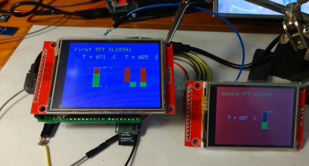

I'm looking at running 2x ILI9341 displays. One on SPI1 and SPI2 (SPI0 is used). Is there any issues with using the sdio pins for SPI2 or am I best to use the PSRAM Pins?
It seems to me that you can connect the two displays in SPI1, you just have to use different CS and generate two control instances in the header, for example tft_1 and tft_2
Teensy 3.2: ILI9341 2.8" and 2.4"
PD: I would recommend using an external source to supply the backlight power to the displays, to prevent some uninvited smoke.
