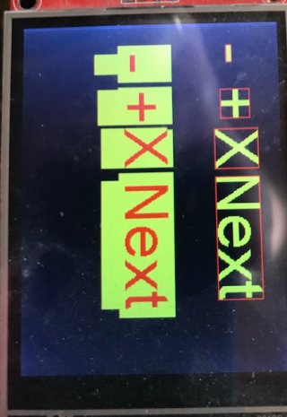

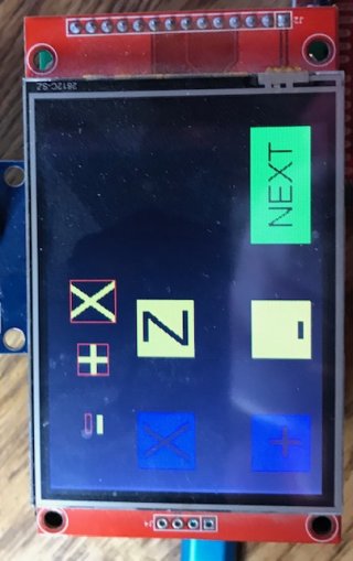

#include <ILI9341_t3n.h>
#include "ili9341_t3n_font_Arial.h"
// Settings and objects
#define TFT_DC 9
#define TFT_CS 7
#define TFT_RST 8
#define TFT_SCK 13
#define TFT_MISO 12
#define TFT_MOSI 11
#define TOUCH_CS 6
ILI9341_t3n tft = ILI9341_t3n(TFT_CS, TFT_DC, TFT_RST, TFT_MOSI, TFT_SCK, TFT_MISO);
void drawTextWithBoundingRect(uint16_t x, uint16_t y, const char *str) {
int16_t x1, y1, w, h;
tft.setCursor(x, y);
tft.getTextBounds(str, x, y, &x1, &y1, &w, &h);
tft.print(str);
tft.drawRect(x1, y1, w, h, ILI9341_RED);
void drawCenteredText(uint16_t x, uint16_t y, uint16_t w, uint16_t h,
const char *str) {
tft.fillRect(x, y, w, h, ILI9341_YELLOW);
tft.setTextColor(ILI9341_RED, ILI9341_YELLOW);
tft.setCursor(x + w / 2, y + h / 2, true);
// tft.setClipRect(x, y, w, h);
tft.print(str);
// tft.setClipRect();
delay(3000);
while (!Serial && millis() < 5000) ;
Serial.println("Teensy 3.2 TFT Clock Program");
#pragma region DISPLAY INITIALIZATION
Serial.println("Initializing TFT display");
tft.begin();
tft.setTextColor(ILI9341_YELLOW);
tft.setTextSize(2);
tft.setRotation(1);
tft.setFont(Arial_40);
drawTextWithBoundingRect(20, 20, "-");
drawTextWithBoundingRect(60, 20, "+");
drawTextWithBoundingRect(100, 20, "X");
drawTextWithBoundingRect(140, 20, "Next");
drawCenteredText(20, 100, 35, 50, "-");
drawCenteredText(60, 100, 35, 50, "+");
drawCenteredText(100, 100, 35, 50, "X");
drawCenteredText(140, 100, 130, 50, "Next");
void loop(void)
#include <ILI9488_t3.h>
#include "ILI9488_t3_font_Arial.h"
#define TFT_DC 9
#define TFT_CS 7
#define TFT_RST 8
#define TFT_SCK 13
#define TFT_MISO 12
#define TFT_MOSI 11
#define TOUCH_CS 6
ILI9488_t3 tft = ILI9488_t3(TFT_CS, TFT_DC, TFT_RST, TFT_MOSI, TFT_SCK, TFT_MISO);
tft.print(str);
tft.drawRect(x1, y1, w, h, ILI9488_RED);
const char *str) {
tft.fillRect(x, y, w, h, ILI9488_YELLOW);
tft.setTextColor(ILI9488_RED, ILI9488_YELLOW);
tft.print(str);
tft.setClipRect();
delay(3000);
tft.begin();
tft.fillScreen(ILI9488_BLACK);
tft.setTextColor(ILI9488_YELLOW);
tft.setTextSize(2);
tft.setRotation(1);
drawCenteredText(100, 100, 40, 50, "X");
drawCenteredText(150, 100, 130, 50, "Next");
void loop(void)
