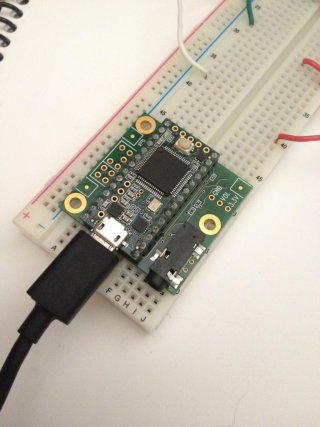

I am trying to play an audio file from a micro SD card while simultaneously record an audio signal to pin 14 a(0). I am having trouble communicating with the SD card. The board is selected on Teensy 3.2 which shows up on port 6 in my device manager. I select port 6 in the IDE and began with an example code found under the tab file>>examples>>SD>>cardinfo. The only line changed was from
const int chipSelect = 4;
to
const int chipSelect = 10;
However the code wouldn't even compile giving me:
error compiling for board Teensy 3.2/3.1.
So next I try an example found on the forum:
https://forum.pjrc.com/threads/540-ChibiOS-RTand-FreeRTOS-for-Teensy-3-0
which directs me to download a library, SdFatBeta20130621.zip. I placed the SDfat in libraries folder found in documents>>Arduino>>libraries
the SdFatBeta20130621.zip download can also be found here:
https://code.google.com/archive/p/beta-lib/downloads
I then try the SDfat example, exactly as is, through file>>examples>>SDfat>>quickstart
It compiled an uploaded via com 6 to the Teensy. Opening the serial monitor it asked me to enter the chip select pin number in which I entered 10.
The feedback read:
SD initialization failed.
Do not reformat the card!
Is the card correctly inserted?
Is chipSelect set to the correct value?
Is there a wiring/soldering problem?
errorCode: 0x1, errorData: 0x0
To not confuse my wiring I have inserted a picture that shows the Teensy placed on top of the shield match the left and right 14 pins.
teensy w: shield.jpg
Am I doing something wrong? How can I get the Teensy 3.2 to communicate with the SD card (preferably through the audio shield instead of another SD card adapter.
The audio shield uses pin 14 for SCK.
Paul, for a small business you are very on top of things and I thank you for such a timely response. But with the shield parallel with the Teensy 3.2 isn't that arbitrary. Should I not stack the shield and Teensy together? Earlier I gathered that the sck of an SD card reader (3rd party) should be connected to 13 on the Teensy. Is this correct?
You can use either Pin 13 or 14 as SCK when using SPI. But on the Audio Adaptor, Pin 13 is in use for the I2S communication (RX) to connect to the SGTL5000 IC. So only Pin 14 is left to use for SPI SCK.
Since Pin 13 is the default SPI SCK pin, it is recommended as the "standard" SCK pin, like for 3rd-party SD-adaptors.

These answers are good but they aren't solving the original problem. I cannot communicate with the micro SD inserted into the audio shield which is placed on top of the teensy 3.2, just as shown in the picture of my original post. I am assuming, after watching the audio shield demo on youtube, that the shield is supposed to work just fine in this configuration. So which pin is the sck pin that should be used is arbitrary, I think. I did realize that the version of Arduino IDE 1.6.10 has a problem with the version of Teensyduino, which is necessary in order to communicate with the Teensy. I switched computers which has Arduino IDE 1.6.9 and leaving the shield connected to the header pins of the Teensy was able to upload the simple blink example found in File>>Examples>>Teensy>>Tutorial1>>Blink. The controller started blinking its on-board LED. However when I go to File>>Examples>>SD>>cardInfo I have to change a single line to use the teensy audio shield:
The original line - const int chipSelect = 4;
changed to - const int chipSelect = 10;
The serial monitor will read:
Initializing SD card......Initialization failed. Things to check:
is a card inserted?
is your wiring correct?
did you change the ChipSelect pin to match you shiled or module?
I don't know what is going on but I have 3 of Teensy 3.2's and 2 audio shields and none of them will read the SD card. Please someone help me find an answer to this......
Thanks in advanced
Steven
you're right; that example needs an update.

can you try this, pls, and report back ?

Frank B I tried your suggested code but I'm still getting the same error:

The last thing I haven't tried is swapping the micro SD. It is the only micro I currently have and bought it brand new so it should be just fine but who knows. I will try this tomorrow.
This works and plays the 4 named wav files.......with teensy connected to Audio adaptor as per the pjrc documentation

There must be something wrong with what is happening at this line in your sketch
if (!card.init(SPI_HALF_SPEED, chipSelect)) .....??????
Is SPI HALF_SPEED ....?????
Is chipSelect getting set or not.......measure ir with a meter...????

It didn't work. I tried the wav file player and the blink while playing examples and both didn't play any audio. This is on a new micro SD with the same SDtest 1-4 files and the ones I want to use for my project. I am connecting a headphone into the headphone jack with . I took a scope to the line out outputs of the audio shield and it is showing noise around 20mV with a DC offset of about 25mV. This voltage, if an audio signal were detected should be 100mV or so preferably with no DC offset. I don't think I have audio on those pins. I failed to mention earlier but I have a 1k audio rated pot on the ports for the volume. I don't know if I have any other choices but to buy the test kit if I want it to work with ease.

// Arduino Ethernet shield: pin 4
// Adafruit SD shields and modules: pin 10
// Sparkfun SD shield: pin 8
// Teensy audio board: pin 10
// Wiz820+SD board: pin 4
// Teensy 2.0: pin 0
// Teensy++ 2.0: pin 20
while (!Serial) {
; // wait for serial port to connect. Needed for Leonardo only
SPI.setMOSI(7); // Audio shield has MOSI on pin 7
SPI.setSCK(14); // Audio shield has SCK on pin 14
Serial.print("\nInitializing SD card...");
// we'll use the initialization code from the utility libraries
// since we're just testing if the card is working!
if (!card.init(SPI_HALF_SPEED, chipSelect)) {
Serial.println("initialization failed. Things to check:");
Serial.println("* is a card inserted?");
Serial.println("* is your wiring correct?");
Serial.println("* did you change the chipSelect pin to match your shield or module?");
return;
Serial.println("Wiring is correct and a card is present.");
// print the type of card
Serial.print("\nCard type: ");
switch(card.type()) {
case SD_CARD_TYPE_SD1:
Serial.println("SD1");
case SD_CARD_TYPE_SD2:
Serial.println("SD2");
case SD_CARD_TYPE_SDHC:
Serial.println("SDHC");
default:
Serial.println("Unknown");
// Now we will try to open the 'volume'/'partition' - it should be FAT16 or FAT32
if (!volume.init(card)) {
Serial.println("Could not find FAT16/FAT32 partition.\nMake sure you've formatted the card");
return;
// print the type and size of the first FAT-type volume
uint32_t volumesize;
Serial.print("\nVolume type is FAT");
Serial.println(volume.fatType(), DEC);
volumesize = volume.blocksPerCluster(); // clusters are collections of blocks
volumesize *= volume.clusterCount(); // we'll have a lot of clusters
if (volumesize < 8388608ul) {
Serial.print("Volume size (bytes): ");
Serial.println(volumesize * 512); // SD card blocks are always 512 bytes
Serial.print("Volume size (Kbytes): ");
volumesize /= 2;
Serial.println(volumesize);
Serial.print("Volume size (Mbytes): ");
volumesize /= 1024;
Serial.println("\nFiles found on the card (name, date and size in bytes): ");
root.openRoot(volume);
// list all files in the card with date and size
root.ls(LS_R | LS_DATE | LS_SIZE);
void loop(void) {}
To follow up in case anyone is interested, I uninstalled Arduino 1.6.? (I don't remember what I had installed) and updated to Arduino 1.8.1. I also updated teensyduino with the beta 1.35 for Arduino 1.8.1 which can be found here. I reran the sample SdCardTest sample sketch and it worked without having to modify anything!
