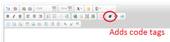

is there a way -tags or otherwise - to format attached code? If I copy and paste code in it is wrapping long lines and removing indention.
use the [ CODE] and [ /CODE] tags for that.
If you want to see all tags, click on the 'Go Advanced' button below the Quick Reply field :)
Unfortunately the forum software hides the button that inserts code tags, unless you click 'Advanced'. Its the button that looks like this: #
You can also attach the file. Click "go advanced" and then it's Manage Attachments below your message. Often when looking at someone's, I load it into vim, so I get familiar syntax highlighting. But the code tags work nicely for small bits of code.
