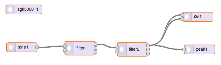

With the help of others on this forum I got my response plotting code to work but I'm having a hard time justifying what I am seeing. I've included the code and the response data below.
Basically I have two cascaded low pass filter section set at 1000Hz each connected to a peak detector so I can see the filtered output. A sine wave generator is being swept from 40 Hz to 20000Hz and is driving the filter network. If you look at the response data you will see that the cascaded filters are already over 12 db down at 1000Hz and 54 db down an octave out. I would expect the roll off to be approximately 24 db/octave but I'm getting 42 db/octave instead.
What am I missing ?

take log10 and not log
