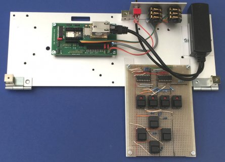

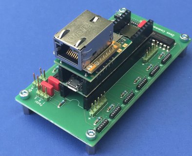

A Teensy 3.5 is used because of it’s 5V tolerance, this makes it easy to connect optical rotary encoders operating on 5V. Ethernet is provided by a WIZ850io module mounted on a PJRC adapter board. I created a PCB to hold the Teensy and connectors, there are connectors for 3 serial displays, 8 Bourns EM14 series optical rotary encoders with switch, a continuous foot pedal, two switches and an external board with illuminated buttons. A shift register is used for reading the encoder switches, a buffer is used to drive the external shift registers on the button board.
An Adafruit PoE (Power over Ethernet) splitter (5V, 2.4A) is used to power the controller. Compared to (standard) USB (5V 500mA) PoE can deliver more power over much greater distances so it makes good sense to use PoE. Sure, it requires an PoE network switch but these are more commonplace now given the ever increasing use of audio over IP (AES67, AVB, Dante ,Ravenna etc.) in studio and live applications.
A certain minimum power has to be drawn for the switch to activate the PoE delivery. I did some testing with a Led to check the voltage but this resulted in the LED being turned on and then off again continuously because the current drawn was to low. PoE status can be monitored through the network switch web interface:

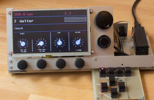

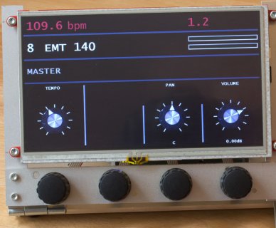

The controller currently has four modes: track, inserts, plugin and master. The picture at the top shows the track mode. The first and second ‘row’ on the display are common to all modes. On the first row the tempo (bpm) and song position (bars.beats) are displayed. The large scroll wheel on the right is used for scrolling through the song one bar per click. If the cursor is not at the first position of a bar the first click will set it there. This is done using Reaper actions.
The second row is used to display the track number and name and also for the stereo level meters. The track name, and all other names on the display, can be 18 characters long.

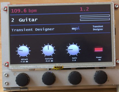

The third row displays the current mode or, in case of plugin mode, the plugin name and if the plugin could be identified also the icon associated with the plugin. The fourth row contains the virtual knobs for four parameters and their labels and values. The smaller scroll knob on the right of the display is used for scrolling through the tracks.
In track mode two sends, track panning and track volume are displayed, using the left and right navigation buttons two more sends can be displayed. Notice that the bus track name is available for the sends which is really great.

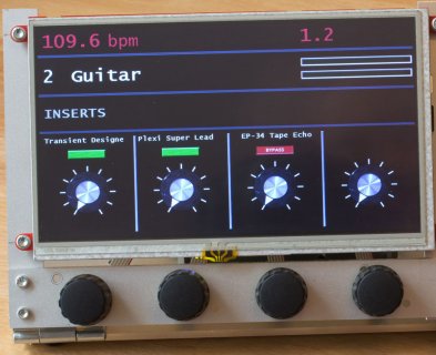

Inserts mode shows the status of the track inserts, there are two pages of 4 inserts. Unfortunately the insert mix parameter doen’t work so the rotary part of the encoders doesn’t do anything yet in this mode but the pushbutton function can be used to activate or bypass inserts. One of the great things of the Reaper OSC implementation is the fact that the sent names of the plugins, and also those of all parameters for that matter, are the custom names you can enter in Reaper if you want to. In my case I have a bunch of UAD plugins which by default all have names starting with UAD , I changed all the names and dropped the UAD prefix.
The virtual knobs are actually just image stacks as explained in this thread on the 4D Systems forum. ImageMagick was used to generate knob images for each degree from 0 to 300. There are currently 1280 images (120x120 pixels) in the stack, these are stored on an SD card on the display itself. The display is programmed using the free WYSIWYG UI design (Windows) application. The Teensy just sends commands to the display over serial what image to display on which control.
One of the big issues with universal controllers is that they’re universal, they do not reflect the UI of the device they represent, more often than not you have to look twice to figure out what plugin you’re looking at. A more customised view requires meta information on the plugin and it’s parameters which is currently unavailable through OSC so I resorted to adding meta information in the code and identifying a plugin by name. An icon is associated with a plugin to make it more obvious which plugin is selected and the look of the controls can be adapted to better reflect the function. Several meta parameters are associated with a plugin parameter

The main use case for having the step count is to be able to display a button for on/off type parameters. The image offset is used to display different types of virtual buttons/knobs. The value map consists of a boolean to indicate that there is a map, a low value, high value, precision and a unit for display.

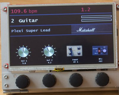

ImageMagick is also great for grabbing a selection from plugin UI screenshots, resize the selection and add a little sharpening all in one go. The input and mic select parameters are examples of this:

The master mode is used for easy access to master metering, panning and volume and also to set the tempo:
